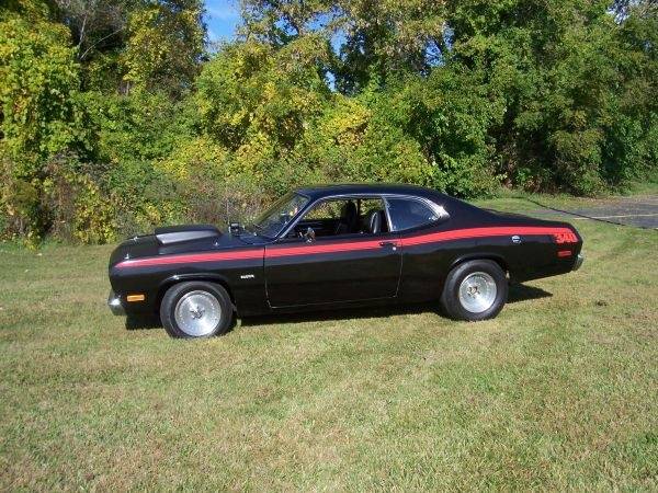

Like the guys said, bolt on the way to go, you can't use the stock springs with the fiberglass hood so your options are the smaller springs or prop rod.

Thanks for the link and the heads up guys .. I definitely don't like the idea of propping the hood open either ...

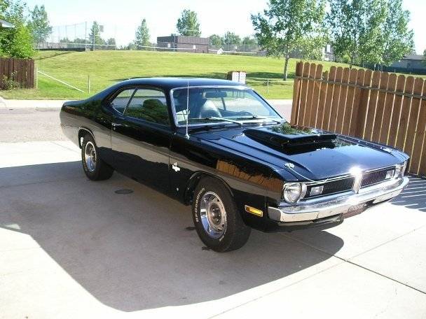

I have a pin on AAR hood. The pin on is a pain at times, but makes things really easy when wrenching, though.

Don't want to interupt; Demon Seed- That's a beautiful paint job.
No ****!! Demon, I would dearly love to do my Duster all black but my body working skills won't allow it. :angry7:

That's funny ramcharger, cuss the guy that did the prep and paint swore he'd never ever do another black one. You see with that black and 3 coats of clear if the sheet metal isn't perfect, no ripples, that paint will show it plain as day. Dave spent a lot of time wet sanding the body before paint and I think he's hated me ever since. Since the hood was an after thought I had a local guy do the prep and paint on it, he runs a business rebuilding and painting old vettes so I figured he'd know how to do fiberglass and I was right. It's a perfect match.:toothy10::toothy10:
