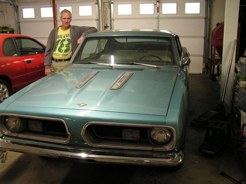

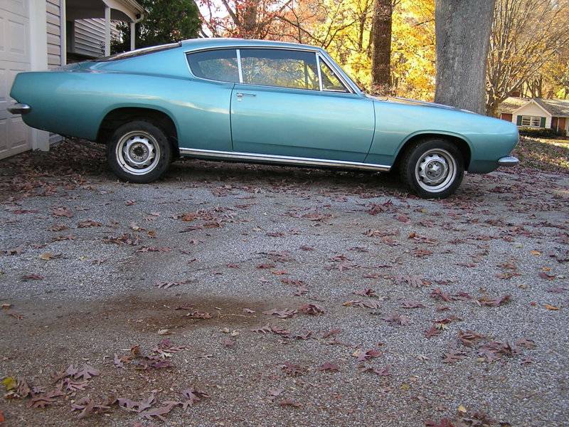

I like the Medium Turquoise. Here is a picture of my brother Tom and his first car, 67 Barracuda.
Yeah I am liking the looks of the Medium Turquoise like on your Brother's Barracuda, it's got a little more blue in it giving it a bit more Blue Green look.

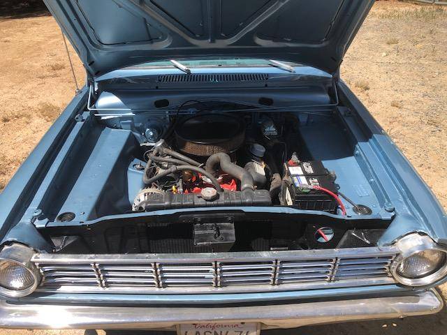

The '74 Dart G2 Frost Green above could use more blue in it too to make it look better.

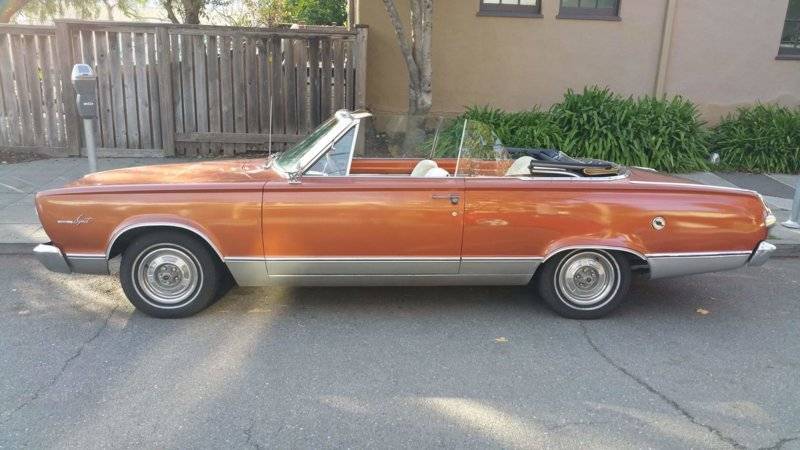

I suggested Turbine Bronze which could look fantastic with the right amount of metallic.
Sorta like this (I doubt these are Turbine bronze but use your imagination)
