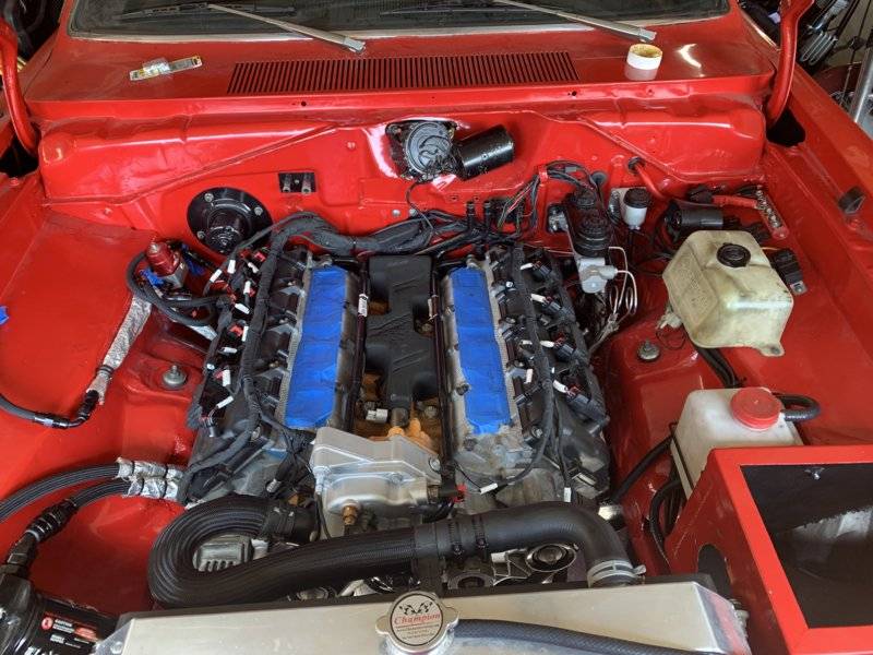

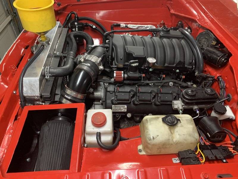

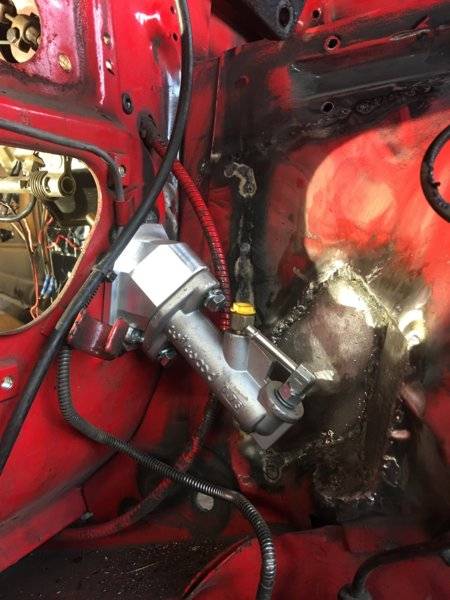

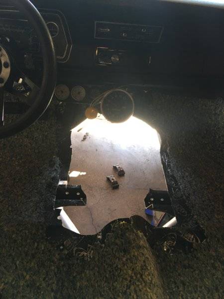

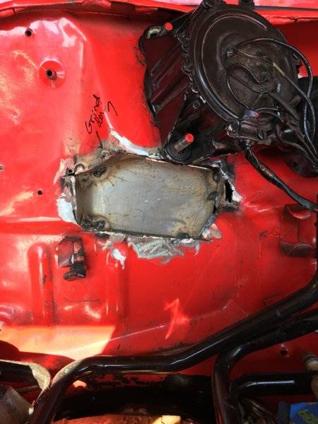

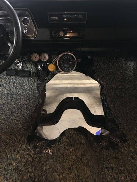

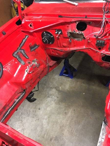

It took longer than i thought to do the whole swap, but it was engine and trany swap... plus lots of reinforcing too
70 duster
6.4 out of SRT jeep
T56 kit from silver sport transmission
Mopar performance engine controller
MMX cam, throttle body and tuning

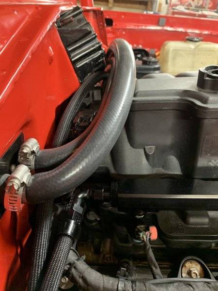

TTI 2" headers to 3" exhaust x pipe and to the bumper
some pix were still under construction

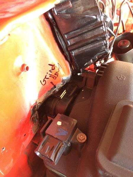

I kept the 6.4 intake runner motor, with factory windshield wiper motor!! And the computer is right in front of stereo, below wiper linkage..... its tight, but it all fits
Kept the glove box!! This is a street car! Lol
