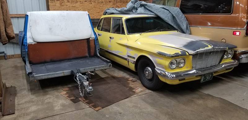

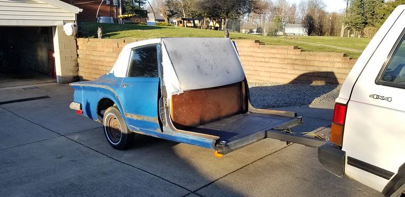

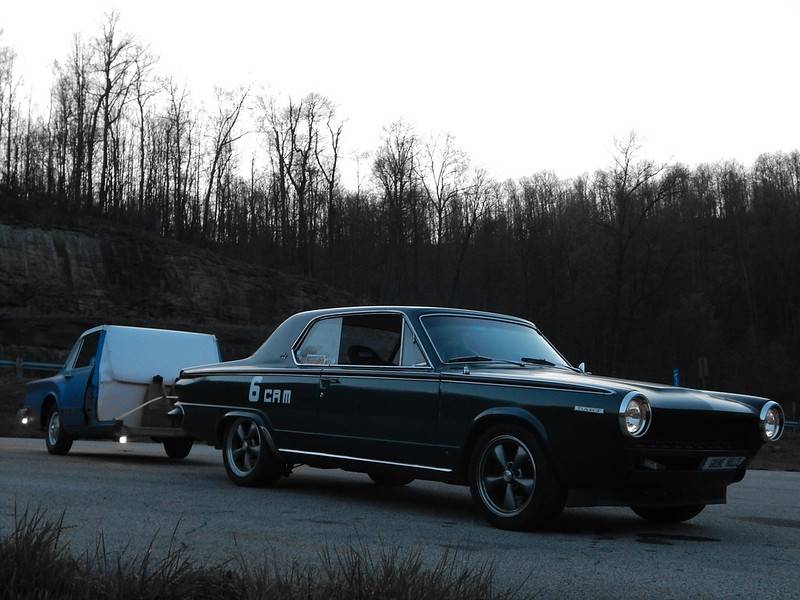

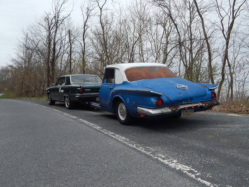

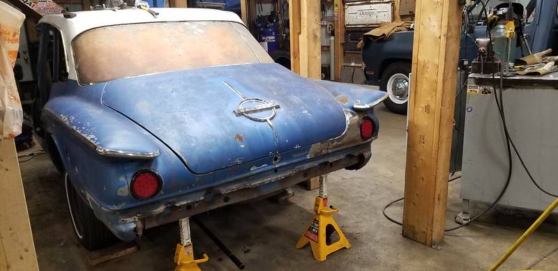

Here is a small project that I have been slowly working on:

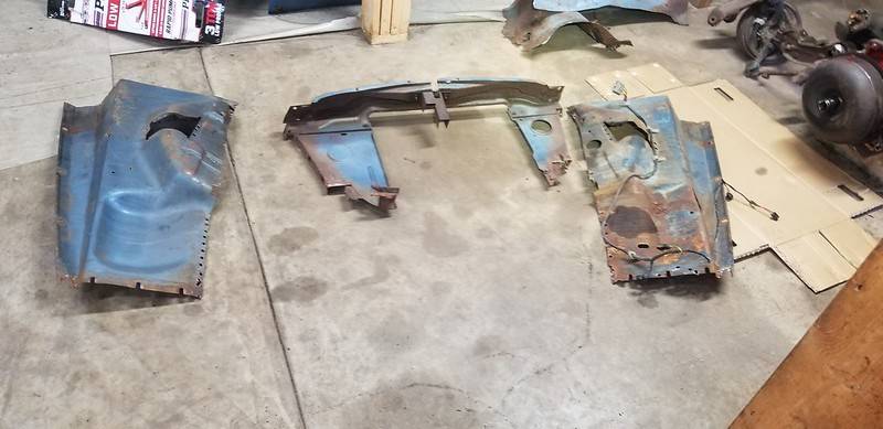

I bought a 1962 Valiant Parts car, I got the good bits saved / Front half taken off, Spot welds cut etc... then I thought this might make a nice trailer, so Here it is.
All of the sheet metal to make the enclosures and floor is MoPar as well.
I have saved the roofs and trunk lids of rotted parts cars for the free sheet metal... there is some '64 Dart / '69 Dart and '79 Volare in the trailer too.
It's not totally done, but the major bits are complete and most of the wiring and paint is done now.
Now I need to get a hitch installed on one of my slant 6 Cars to pull it.
Greg

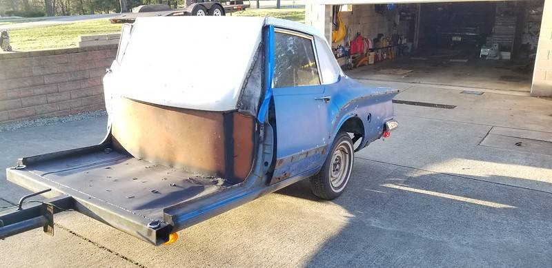

nice one, you could make an open 'tray' section at the front easy enough too. handy for carrying taller parts/plants or cherry picker access for motor/trans shipping.
neil.
neil.

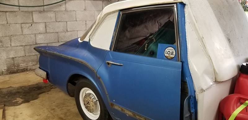

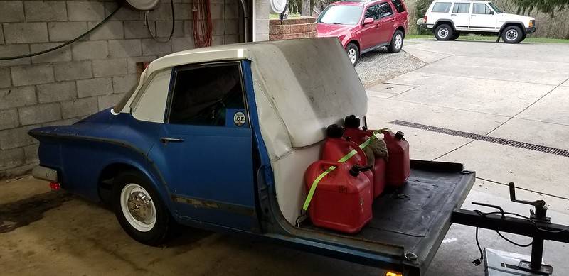

Hi Neil, It may not show so well in the pictures but yes there is an open flat section on the front between the rockers and the trailer tongue that is flat/open for engines/ wheels/tires axles etc.
Cheers!
Greg

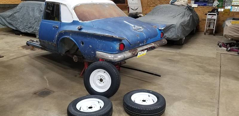

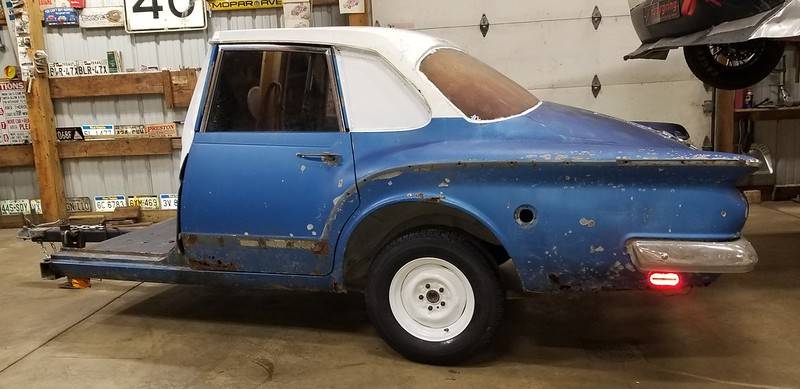

I Finally Found a Use for all those Pesky13" x 4 1/2" OE Wheels:
They work perfect for trailers that are using small bolt pattern such as the ValianTrailer. Cleaned them up, put some paint on them to match the roof.
Buffing supplies are on the way to clean up 2 of the OE '62 UFO Valiant hubcaps than I will toss them on the trailer as well.
- A few more to-do's:
- Paint the Orange Panel that filled in between the front folded down Roof and the floor... Bought Some more white paint for that.
- Make a Block off for the fuel filler - Weld it all up and Paint it Blue and this trailer will be done.
Some Photos:
Pesky 13x4 1/2's came in handy on this project... Mouted up some Fresh ST 175 80 13's along with new valve stems.
Lightened up the Rotating assembly and removed the backing plates and brakes.
The Wheels help it to look somewhat completed.

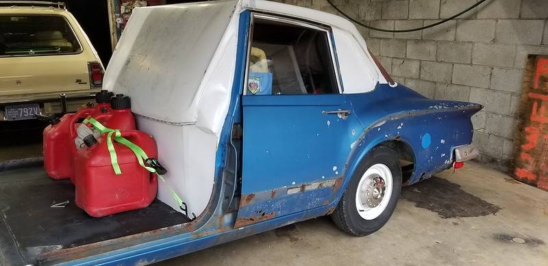

Also Got some "Heavy Haulin'" Bits installed:
Now I Can Tie stuff down and not have to worry that it will go flying around on the corners.

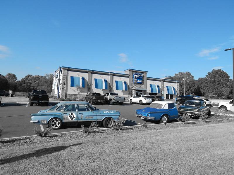

Hangin' out with the other '62:
Greg

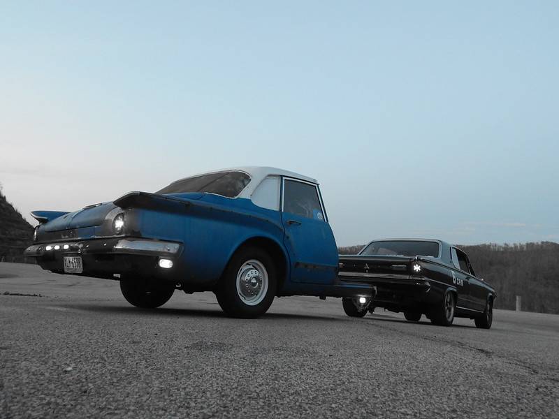

Thanks, Those are all Probably wise additions, I think I have the Lights already Covered, They are tucked under the rocker panel as well as the Bumper, but they are there.
Greg

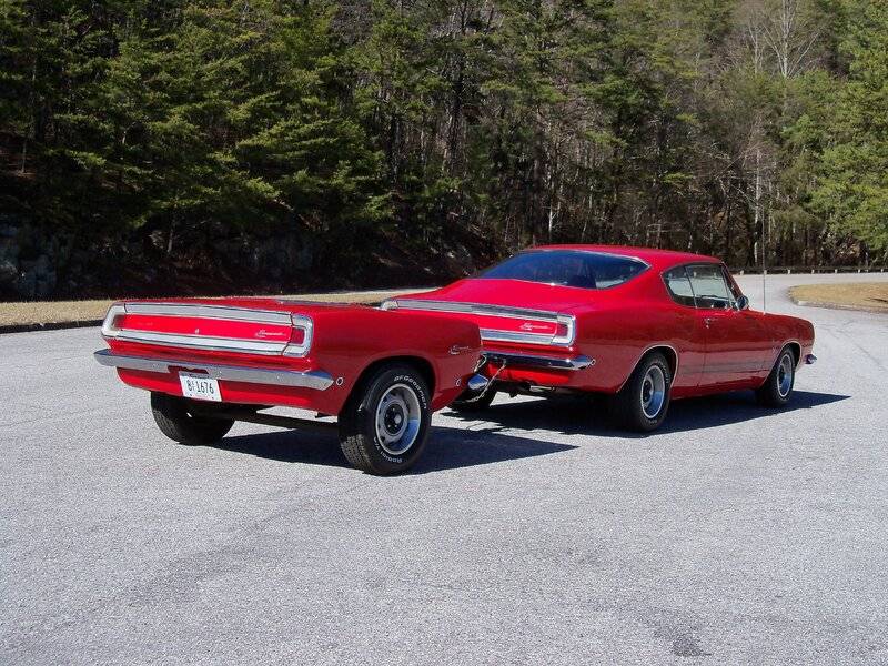

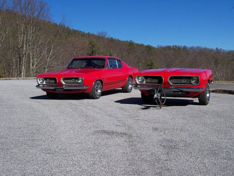

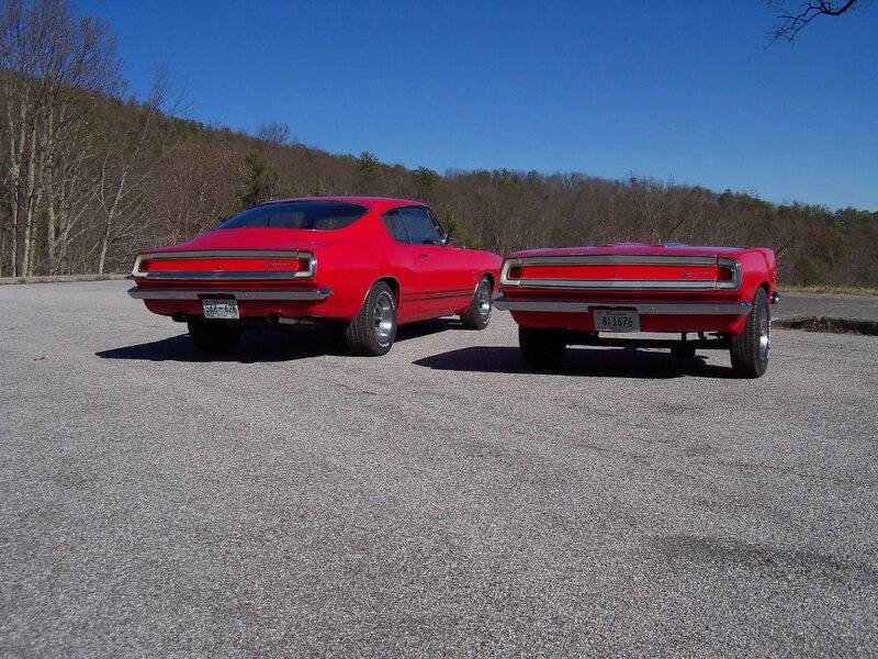

Here is some inspiration. I made this in 1998. It draws a crowd. I call it "CudaTail"

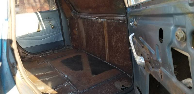

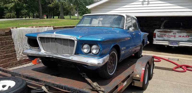

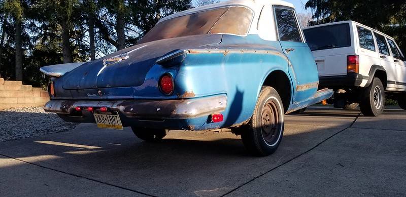

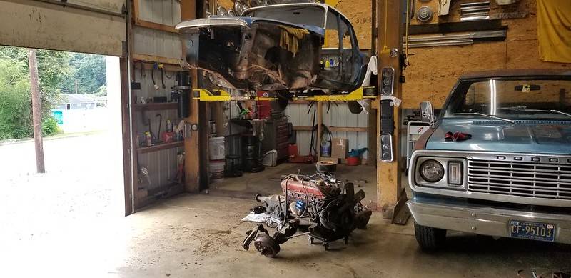

Here it was the Day I Brought it Home in August 2021.. The Car was all there , but it was bad. I bought it for just parts or so I thought.
Sold off or Cut off What I did not need:
Broke out the spotweld Cutter and Surgically Removed / Kept / Stored the panels that only a certified MoPar Nut Like me would ever want or need...
Rusty Floors and Rails Said "No Bueno" for anything other than parts..
Even the Mighty Slant 6 Was Junk - Locked and Loaded full of rainwater. :-(

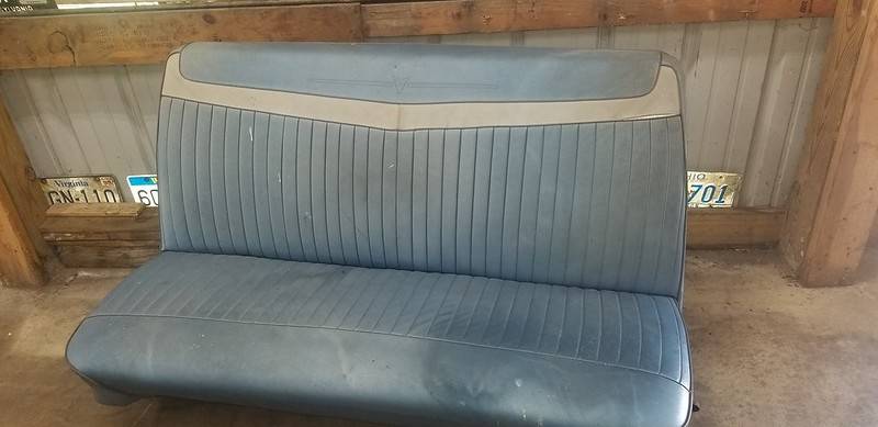

Sold off the Usable Rails And Halfway Decent Front Bench seat.

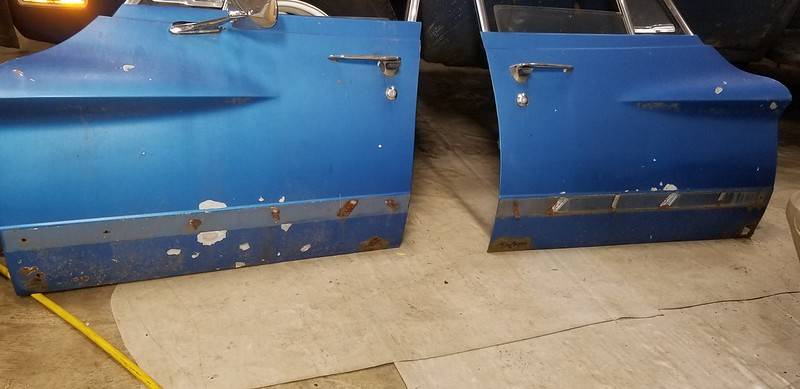

Gave the Front Doors To a friend of mine that Races a '62 Valiant..
The OE Heater Valve may live on in another one of my other valiants some day.. after it gets cleaned up.
During Construction:

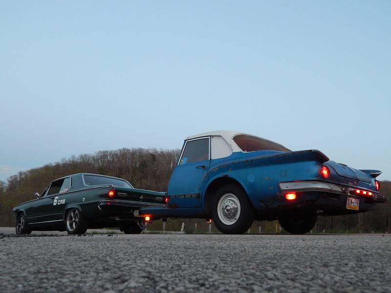

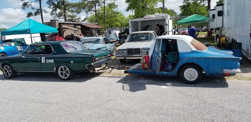

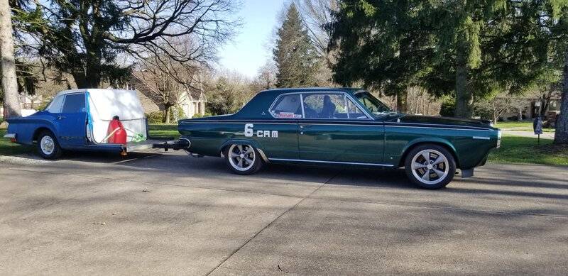

And Now the ValianTrailer is done!!!!
Ready to Carry spare Wheels/ Tires / Gas Etc for that autoX or Track day.. Of course $ome $$ will buy you a prefabbed Box on wheels... Everyone has one of those..
See you at the Track!

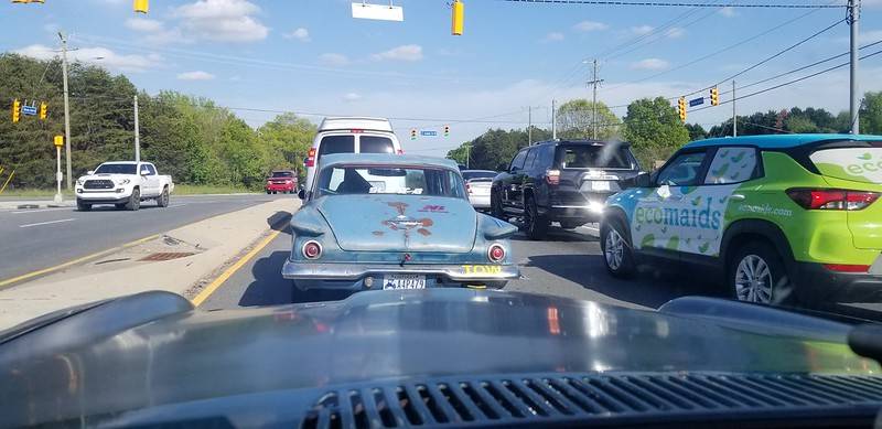

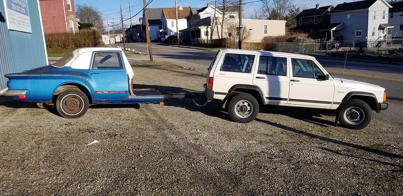

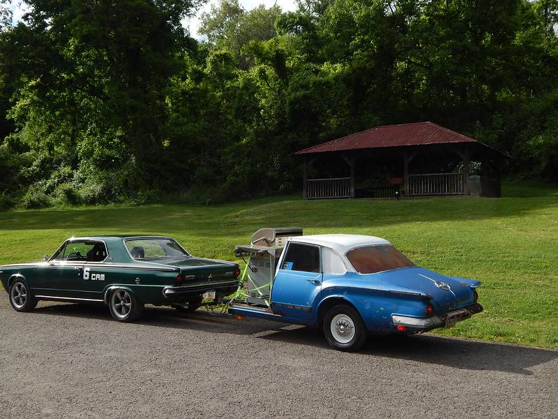

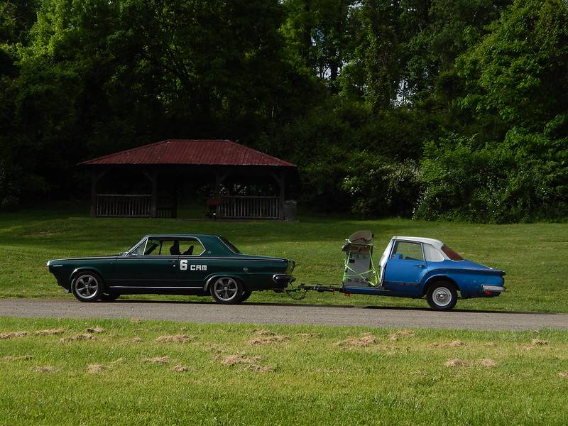

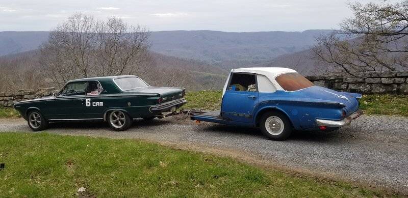

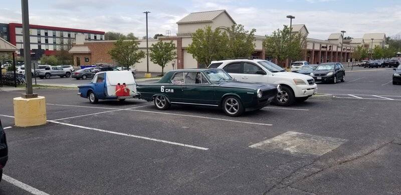

Man that's really cool. How does it pull though with the front almost vertical?
So far its fine. Have not had it in the highway yet or fully loaded.
I put shocks back on it so unlike a small factory built trailer it does not bounce around, even when its empty.
Greg

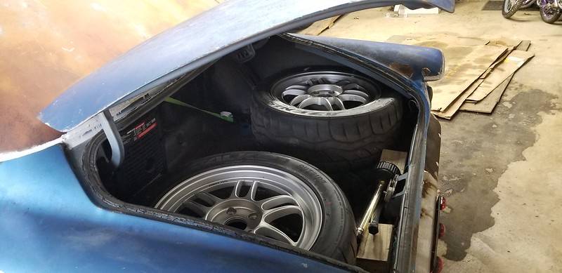

Loaded with generator, 4 wheels / tires/ gas/ generator / MoPar LA small block short block/camping tent / 70# of tools and other various crap.
250# tongue weight
Interstates up to 85... no problem.. over the mountains in Jefferson national forest.. On VA Route 311... no problem.
This thing is skookum as frig and people video it on the highway.
