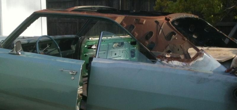

So I finally got around to pulling the vinyl top off the Dart this weekend and now I am freaked out. I guess I was not expecting the disaster that I found. The first picture just gives you an idea of what it looked like before. The roof metal is pitted badly and there are a number of holes all over the roof.
From this before profile the bumps along the roof ridge ended up being a sign of terrible rust.
And the holes in this picture turned into even more holes once this lower section of vinyl came off.
I will try to get some pictures of the actual roof condition posted later. Now I am not sure what to do. I have been told to cut my losses and dump the car (I really don't want to do that). Skim the roof and put on another vinyl top to cover the disaster and let it ride for awhile (I know that is not the best option). I know that replacing/re-skinning the roof is the right way, but that is far beyond my capabilities. And I have searched the area high and low for a donor car, but can't find anything. I read through a number of the "rusted roof" threads from the past, but that spooked me even more. Really need some advice on how you guys would proceed and maybe how you tackled this situation in the past.

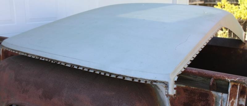

I'd base the decision on how solid the rest of the car is. My bronze GT needs a roof skin because of a vinyl top, looks like it might be a little better than yours but it has holes as well, just not in the lower panels. The rest of the car is solid with exception of the trunk pan, and even that isn't horrible. The roof skin isn't that hard to swap if you can find a donor. I removed a roof skin from a parts car I had, wasn't a big deal with a couple of spot weld cutters. Reinstalling is pretty straightforward with a MIG welder.
Biggest thing is finding the donor. Once you've found a donor, its a couple day operation with a few spot weld cutters and a MIG. I definitely wouldn't write the car off just because of a roof skin. Of course, the rusted roof skin makes it more likely the floors/trunk etc need to be replaced too, and at some point its easier to cut your losses.
Here's a thread I posted on before, lotsa info over there. And a couple of pictures.
http://www.forabodiesonly.com/mopar/showthread.php?t=194845

How about the rest of the car? You need to do a total evaluation. How bad is the rust in the doors, floors, fenders and rails?
How about around the windshield/cowl area?
As I see it now, from the limited view in the pics, also here http://www.forabodiesonly.com/mopar/showthread.php?t=247743
You need a roof and full 1/4s. If a car has holes in the roof, the water goes somewhere, and where it went is more than likely rusted too.

As for the OP's car, based on the other pictures its going to be a tough decision. I'd have to see the tops of the quarters stripped down to metal. There might be enough there to salvage the tops of the quarters and just patch the lowers, but that would also depend on the wheelhouses, trunk extensions, etc. And we really need to see the floors. Worst case it needs the roof, both quarters, wheelhouses, trunk, floors, dutchman, etc. The cost of the sheet metal itself would be higher than shipping a decent donor from the west coast, let alone labor. Best case is the roof, dutchman and quarter patches, with the rest being salvageable. But based on how the roof looks, I'd bet closer to the worst case scenario. Definitely not an easy project either way.
