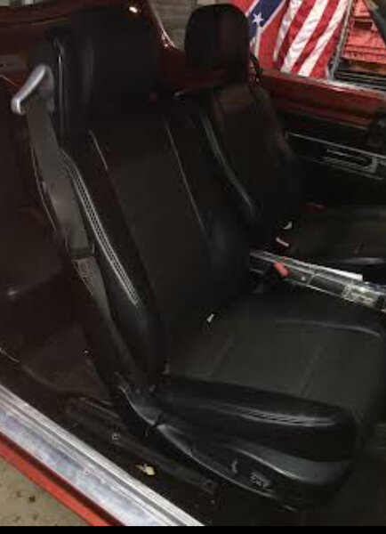

These are BMW 3 series 11 way adjustable Recaro's that I had recovered in two tone.
The BMW has totally flat floors, so custom brackets with spacers on the corners were needed.
My Brother and I built the brackets.
The bolsters were a must to me.
Recaro seats were actually my first choice (I miss my 3-series bmw), but the cost was about twice as much plus as you said the work of custom brackets would be required. I do wish I spent just a bit more money and got seats with the bolsters
