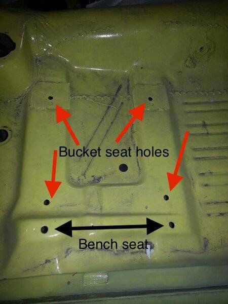

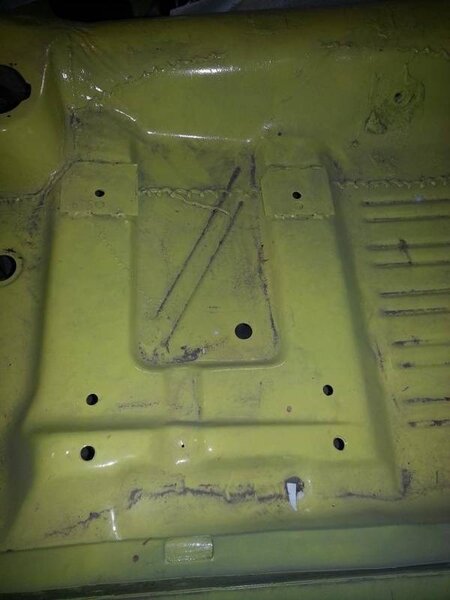

Red squares are bucket and reinforcement plates
Red circles are bucket outer holes
Yellow arrows point to bench holes that get body plugs.
Photo is pass side. Left is front

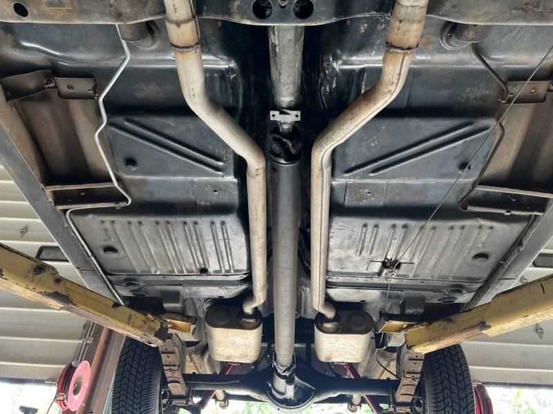

Here are the holes on a 1971 Demon With AMD floor pan. There are brackets under the floor that the outer track studs pass through for support. Under car pic is a file photo showing the brackets under the floor. (LOL....Probably found it on FABO)
BTW....Buckets use the inner holes on the brackets, bench uses the outer.
