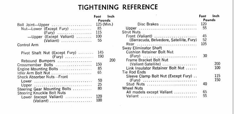

This is 1970 -

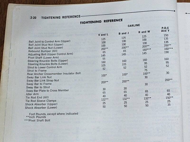

1974 front suspension tightening specifications:
From:
P D C Y (Is For Plymouth Dodge Chrysler Imperial Full size.. The A body components are quite a bit smaller and may not accept those torque values.
