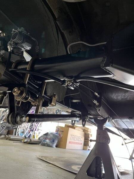

For now I got the brake lines made and e brake lines ran with studs and line clamps. Ready to paint the housing.

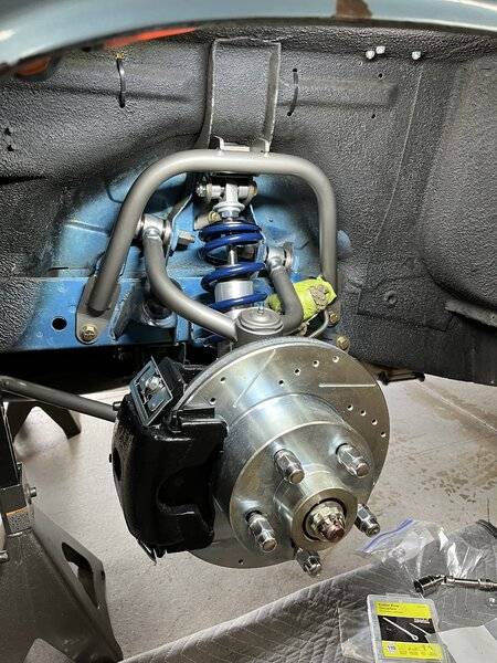

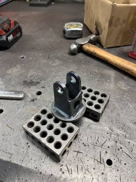

Been putting the front suspension on. Hdk kit is very nice. I had stock strut bars in it with the factory rubber so I made a front adjustable arm. Initially I had someone spin up the rear mount and made an arm to the front with rod ends and clevis style mount in the front. After the install I put it through travel and it bound up pretty bad. I think Chrysler had rubber on the front side so it could sorta telescope through travel because it’s not swinging at the same arch as A arm. Finding out that I raised the rear point high as I could. Now it will freely move and not want to pivot the lower arm in… spindle parts should be here tomorrow and hopefully welded by the weekend.

That's a nifty idea! Does the fact that it ends up a tad shorter cause any issue?

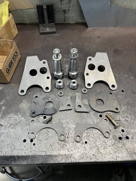

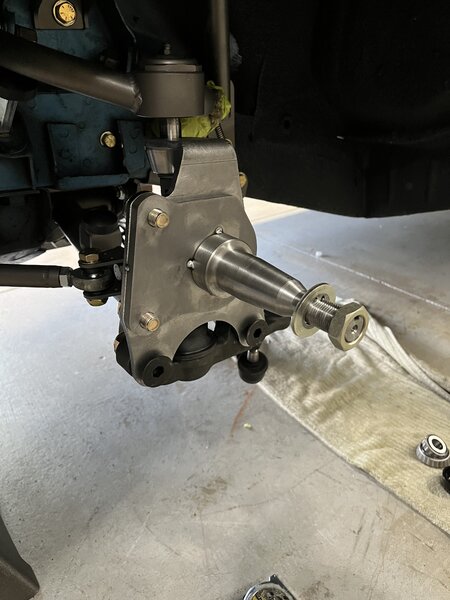

Got one spindle welded up. All looks good. Track width will come in about a 1/4 inch have to countersink the ball joint bolts. Just wanted to see what it looks like assembled first.
