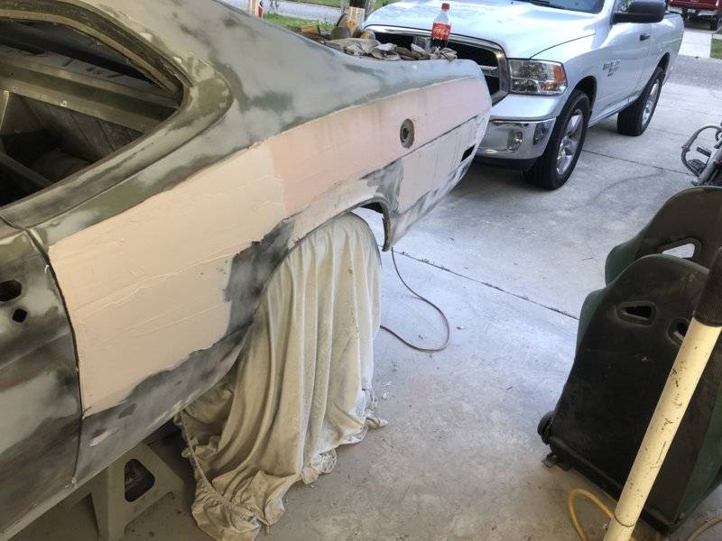

Whew! blocking panels and getting them straight is not for the faint of heart. but i think I am getting close. Center body line is straight and I can now finish out the panel from there.
was too dumb to take some measurements off from the other side for placement of the body style lines. but, I have it corrected now and Im in the home stretch for the right rear. before i do the final shaping I will bolt the door back on to make sure all is well. and then seal it up.

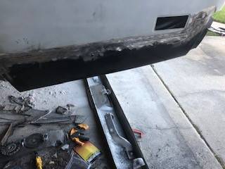

I did manage to get the left rear partial quarter welded in. a couple small wins. :)

Well Made some progress but, its going slow.
finally got the right side down to 220 and starting on the left side.
getting body lines straight is not an easy task.
Looks great! So did you start with bare metal and just fill in the areas that looked low or did you put down the skim coat on the whole thing?
I skim coated the whole panel. I got tired of putting it on and grinding it off only to find another low spot. worked out a lot better and saved a ton of blocking and material i think. the drivers side will go a lot faster.
