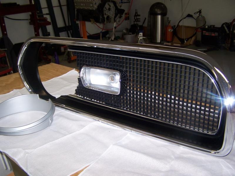

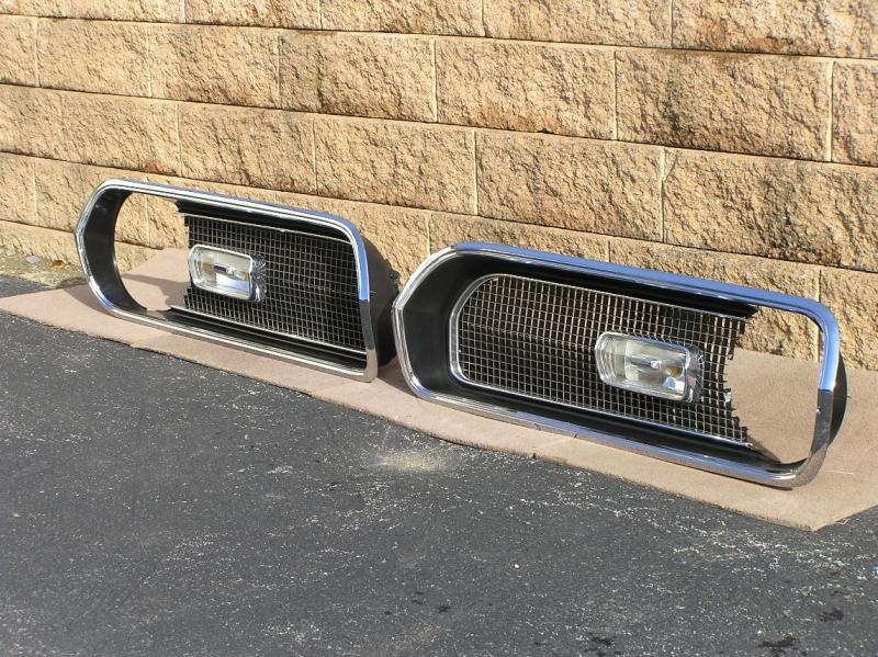

oh, also...I hate to be too technical but does anyone know the 'exact' color and/or a close proximity to the color of the surrounds and the grates. I, of course, have these parts but the are old and faded. It's not a big deal to me to know the exact color, but if anyone else has repaired 69 'Cuda 340 grilles, what colors did you use? (non 'S' models)
http://www.forabodiesonly.com/mopar/attachment.php?attachmentid=322851&stc=1&d=1335187154
Take a look at this pic. I think that the egg crates are satin black. For a 'Cuda the right black for the plastic surrounds is more semi-gloss.
http://www.forabodiesonly.com/mopar/attachment.php?attachmentid=222984&stc=1&d=1301217612
Here is a BBDave's NOS ones. the eggcrates are sprayed from the back and the fronts do not have paint on them.

My A56 'Cuda had black grilles and black surrounds. The surrounds on mine were a little more shiny than the eggcrates, but not by so much they were glossy. It is tough to describe. Hope the pics help.
