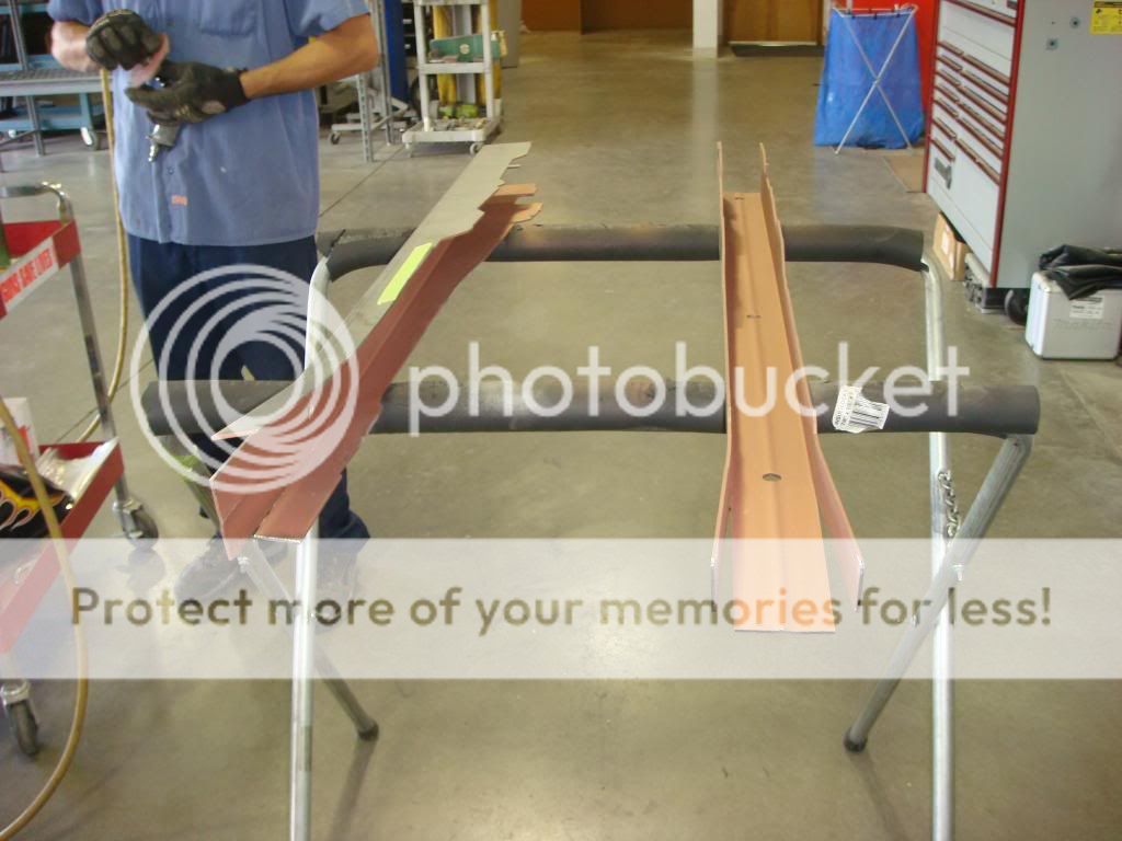

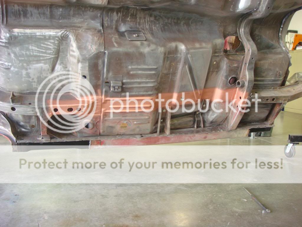

The preparation of the underside of the floor pan was the dirtiest part of the job, cleaning and grinding to make certain there was a good, clean surface for the welds to hold onto.
Cleaned the floor inside and out, used weld thru primer and test fit before welding. Had to grind off a couple high spots and just tap the floor closer to the connectors where needed.
Rbob, that's a nice install...
cheater!!!!!! Nice install though.
