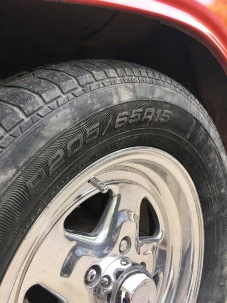

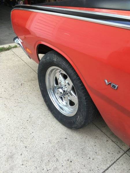

Had to do something so I threw these scabs on. 205/65’s on a 4” rim.
