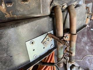

Dismantling my dash for paint and pulled the heater box yesterday and noticed that one of the cable brackets that attaches to the box has pulled away and left a hole behind. I need to reattach it somehow and wondering what the boxes are made of. I could use JB Weld or a fiberglass product, but looking for help and which is better or is there something else to use.
Thanks, see damage below. Box is from my '66 Barracuda and is Model #741.
Thanks for all the suggestions. I decided that glues and epoxies just weren't going to cut it in this situation so I decided a mechanical means of attachment was necessary. So I scrounged a piece of metal from the workbench and riveted it to the heater box and then riveted the bracket to the metal scrap. Looks like it'll work pretty slick. Some of the case clip mounting grooves are also broken out (someone probably replaced the fan motor and butchered the box because they didn't know how the clips work). So I think I'll use a similar idea and rivet some pipe strap the hold the halves together.

Now if you had the best idea all around, how come you asked us bums? lol That looks great.
JB Weld would have been faster and easier.
I had the same issues, it worked perfectly.
Actually it's not faster because of the set and dry time for JB Weld. And this is clearly a high stress spot, I am confident it'll never pull out again.
Yours is now better than factory.
