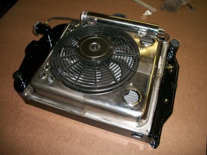

And here's one made out of kitchen trays that looks really good:

LOL. I like it. That actually looks good.
