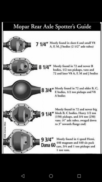

Hello!
Looking at buying a 73’ dart swinger as a donor car for my 69’ GT.
We’re doing a /6 to V8 swap and this seems to be a great candidate.
Can anyone help verify this is an 8.25 rear end? It looks like it to me but I’m doubting my self.
The car is a couple hours away so I’d really appreciate the help!
Thanks!!!
