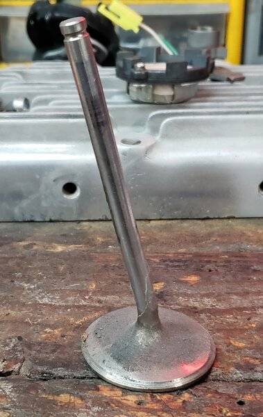

I was after I posted that. and I have one valve number 7 intake valve stuck up. It never hit the piston. So I think it was a issue that had already occurred. Like a bad valve guide on the valve. I tried tapping the valve slightly with a hammer. And it won't pop back up.
....but nice diagnostic work! It's probably bent from tapping the piston.
I think that's the correct decision.....and if it was MINE, they'd both be coming off. Just some friendly advice
I'm going to pull both. But I did go ahead and do a form for summit racing on these heads about this stuck valve. They were bought on April 14th of this year. When I take the heads off I will inspect to see if even that valve even got stuck or it actually got hit. Either way, they will either be returned or I will have to get all new guides and maybe a valve. Because now I don't trust them on the heads.
I understand. Good luck and keep us posted. Good job on finding it!
Either way I'm just going to pull the engine back out. These headers already have such a hard time getting enough space to move there would be no way for me to get to the bottom studs. So engine pulling time.
Probably a smart move. I'd come over and help if we were local.....not that it's worth anything. lol
Replace the valve springs on one cylinder with light "checking" springs. You can get these at most any hardware store. Just hold the valves closed but not enough to collapse the lifters. Then use a dial indicator on the retainer and hand turn the engine to/through 20° BTDC to TDC and then on the other valve from TDC to 20° ATDC. This will tell what valve clearance you have now with you lift. The way to measure is every 5°, open the valve by operating the rocker arm until the retainer touches the stem seal or the valve touches the piston. This will inform how much valve to piston clearance you have and at what ° closest approach is. Depending on your pistons, 0.508" lift these days is not excessive. Older engines only used 0.350" to 0.400" as the spring technology was not as developed. Now you can run 0.600" on the street reliably, provided you double check all clearances and use recommended springs.

I had less than 50 miles on my then new Indy LAX heads (67 Barracuda 360) when all of a sudden had a horrible knocking noise. Got a little quieter, and I was less than five miles from home, so I just drove it home. Pulled the valve covers, saw that the intake valve in the #7 cylinder was stuck open, so I removed that head, expecting the worst. Barely a scratch on the piston, and the valve seat was OK, but the valve looked like this:
Took a chance and only removed the one head. Got a new valve from Indy, machine shop lightly honed the guide to proper clearance, I put it back together and it's been running fine since. And this was almost a dozen years ago. So maybe there's hope for you. :thumbsup:
Another LAX valve issue, when My Bud pulled the 340 out of His AAR, He stuck a 408 stroker with those heads back under the 6bbl setup(which was already running mid/lower 12's). Valve came down & bent, luckily didn't break anything, locks sheared...they sent Him new locks & a valve stating they suspected the hardening of those locks. Been running OK since.

The howards camshaft I got is going to be a a better camshaft for my engine. Yes there are more problems now that I found like the number 7 intake valve dropped because of a bad valve guide. Luckily summit said these heads are under warranty for a year and I bought them in April of this year. So when I get the replacement heads I'm going to get them inspected by arperformance that's near me. One of the best shops in Arkansas. Would it be worth getting them milled to raise compression?

Ok. So great news! Summit is sending me a new set of heads and .039 thickness gaskets under warranty.
