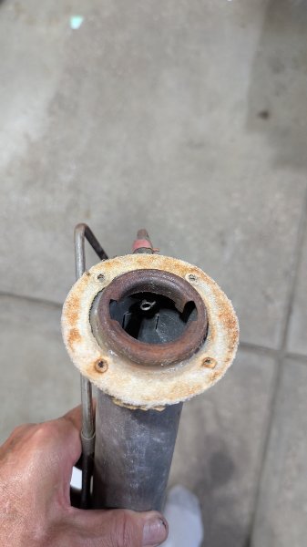

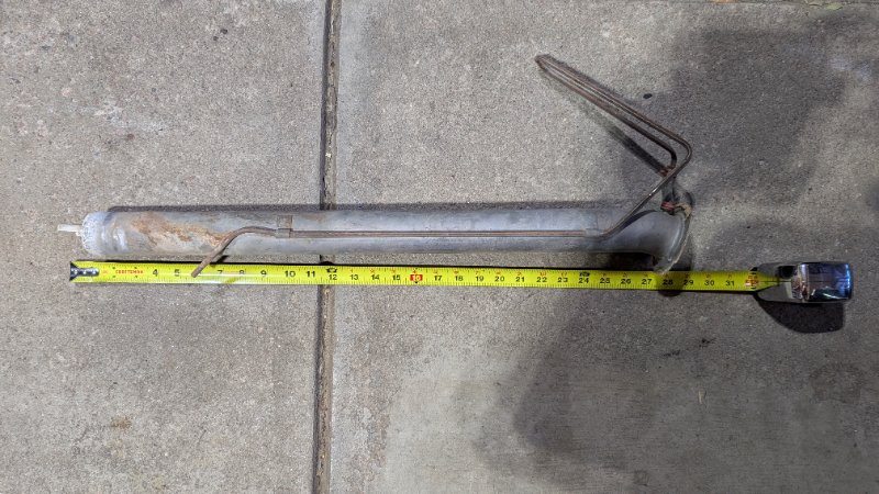

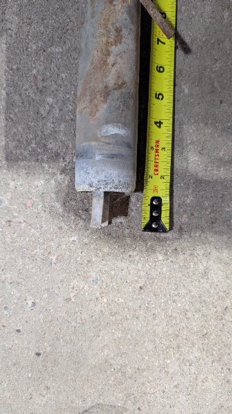

The tube is about 28" long.
Based on the remaining foam gasket. It was mounted from the inside.
There is no vent tube.
The mounting flange has three screw holes.
No vent tube so not 69 and older.
Mounts from the inside of the trunk and has 3 holes. At some point the inlet mounts from the outside and at some point it went to 3 screws.

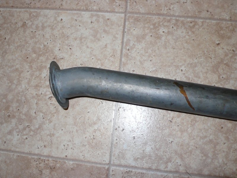

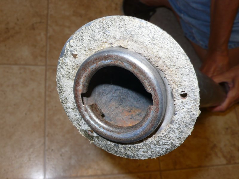

This is 69 to 67 Dart for reference

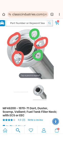

Here is one that it is NOT...
Here is a possibility
3 holes OR 4
No vent tube
You have a 1971 Duster Demon tube. One year only except california 70. yours is a three screw , mounted from the inside with no small vent tube. uses 71 cap only

All Darts and Scamps have 4 screws
