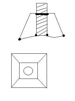

Take the seat off the posts, making sure not to move the lower nut as that will be where the floor/bracket will need to be when you are done with the fab stuff. Then I fabbed up some 4 sided sheet metal pyramids with the point cut off (see pic) . drill a hole in the top of the pyramid and slide down over the threaded rod. now depending on where in the floor the studs are now located I needed to make the bottom of the risers (pyramids) match the contour of the floor ugh..after all of that I welded the risers to the floor and welded the posts to the risers (underneath), cut the rod to about 3/4 of an inch and used acorn nuts to bolt the seats to the floor.
I figured that the pyramid shape and a wide base would give enough strength to handle the weight and surface area to the risers that they wouldn't pull out of the floor....they've held up for almost a year...
