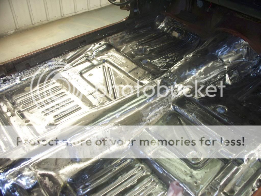

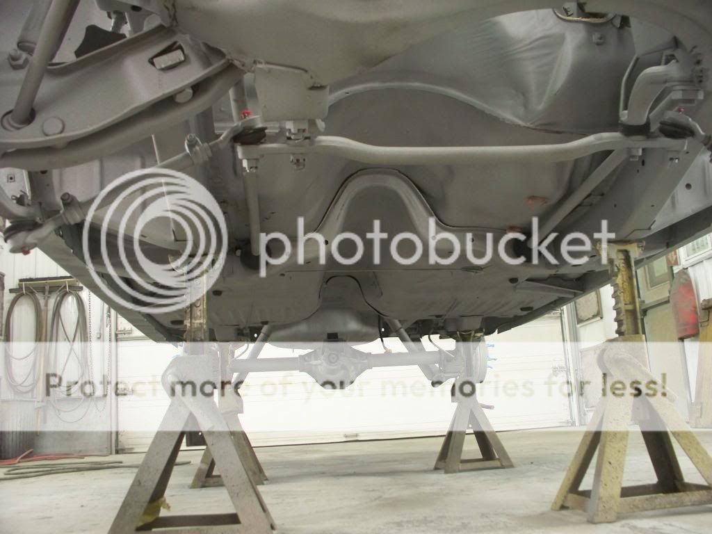

In this photo, look up into the center tunnel, just behind and below the brake cable going across. See that rectangular piece welded to the floor? That is one of the two inboard mounts for the front belts

One from the interior. The "nut" is on the side of the tunnel
