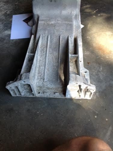

I considered cutting down the car style oil pan but once you do that there would be no real structural integrity left.
Car oil pan
