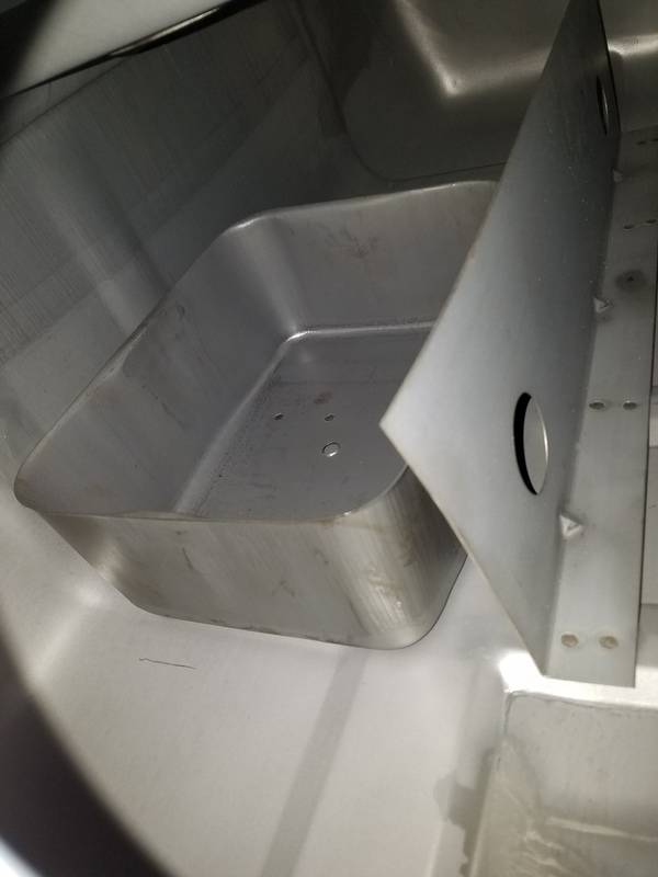

Tanks INC EFI fuel tank
aeromotive 340lph fuel pump
TanksINC close up if anyone is interested in what they look like inside:

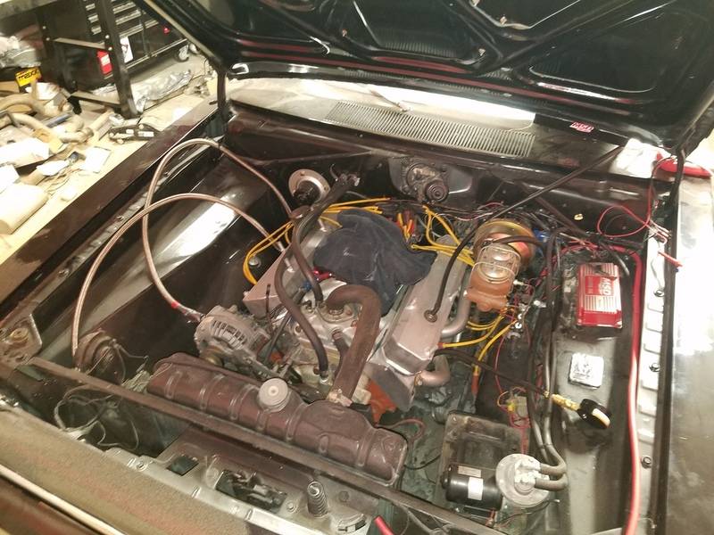

before shot of engine bay:
Intake before:
Intake primer:
Intake Painted:
Cleaned up and back together (+TTi headers):
So there it stands now, sorry not real exterior pics yet, once i get it back out and running it will be all cleaned up and ready for pics.
