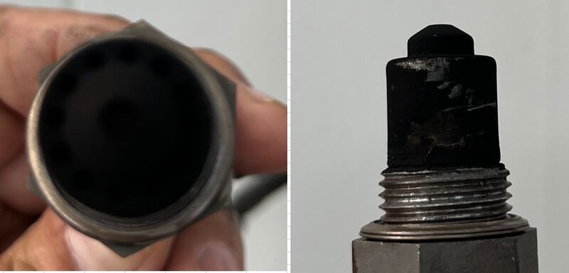

Did you replace the O2 sensor? Maybe I missed that?
Not sure why it would go bad, but since it is a self learning system bad input would mess things up. So an O2 sensor that is reading lean maybe could result in the injectors going full open? Maybe the bad ground caused the system to go lean, pushing the fuel to max and resulting in ruining the O2 sensor due to either a backfire or flooding?
My other guess is that the loose ground fried the ECM.
Maybe try and replace the O2 sensor, reset the ECM and try it again. If it runs rough, I would shut it down right away and look at replacing the ECM.
But just guesses on my part, I don't have any experience with the Sniper systems or anything.

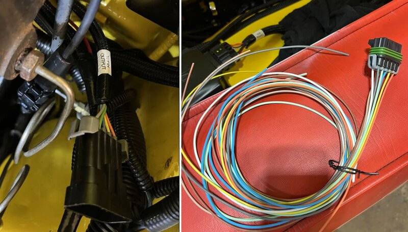

The arming / trigger wire for the EFI SHOULD work fine going to the original coil power WITH the ballast bypassed as you say. However, "it might be" that some worn/ old ignition switches cause a "pause" between and glitch the system. There has been some speculation about this, but frankly I know of nobody who has actually had problems
One thing you want to be careful of is to keep your ignition trigger (distributor) and other delicate sensor wires, dressed against ground, AKA the block and body, and do NOT run any of those parallel to either high tension plug wires OR high current/ high power wires such as the coil primary. EMF / RFI etc.
Thanks DionR. No, haven’t replaced the sensor yet. I never thought the ECM, hmmm could be. I wonder if a guy can test them?

That’s a good point 67Dart273. I need to make sure wires are away from coil, plug wires, etc., especially that pink wire now that I think of it.
As far as the fuel pump, yes theres a relay within the harness that I assume controls it but I’m not certain.
