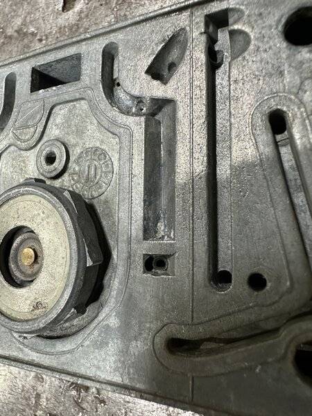

Came across something I’ve never seen before and I’ve done more than a handful of these. I’m going through and building a carb for a friends stroker small block ford mustang street car. He provided the carb. Where it originally came from is unknown but it’s a complete Holley list 80570. The primary metering block has ZERO emulsion holes drilled. Block is numbered 6104-3. I have never come across this at all. Anyone else?

Lets talk about what we see.
I see a low idle restriction, a bleed in the dogleg, and maybe a small bleed into the angle channel.
Seems possible this has a emulsion tube in it. Look at the well plugs on top of the block.
In the mean time I'll see what photos I can find. Might have even posted some here.
Yup. I'd have to dig up the details but this is a block from a Truck Avenger that someone posted and I marked up to show the wells.
The odd thing was that it doesn't connect the air well (and main air bleed) into the main well. I vaguely remember not getting a more in depth look about what makes it tick.

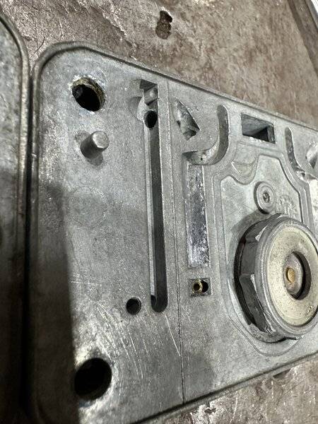

Here's a photo from Tuner of an emulsion tube removed.
Goes right in the main well and is fed air through the hole in the dog leg of the airwell.
The air well in this one looks like it also had e-holes but they are not drilled through. Or they shouldn't be!

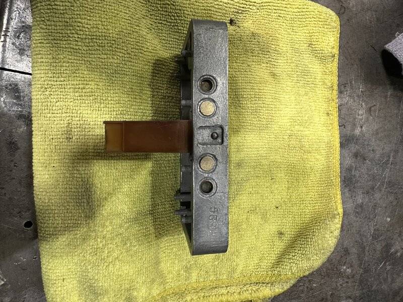

I thought I had one on a 4150 from my friend. Closest I see in my photo files is a Holley spreadbore that is still in my collection. Point is the top view shows the flat top of the brass tube flush wityh the top of the block.
So are we to conclude that the avenger series carbs don’t have emulsion holes in the blocks on the primary side? It sure looks like the block you posted in pic 1 post 8 looks to have no emulsion drilled.
As far as I knew only the truck averngers came like that.

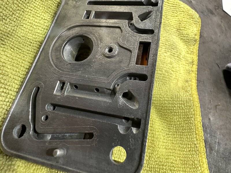

Here's a 770 Street Avernger primary block that someone posted, probably on RFS.
Do you think that block is the block it was sold with?
Need to find someone who has a messed with a few of them. I'm thinking maybe Mike who was on RFS, if he still particpates there.
What's the top of the block look like? All cups or are the main wells flush?
I do. I asked him if he ever took it apart and he said no.

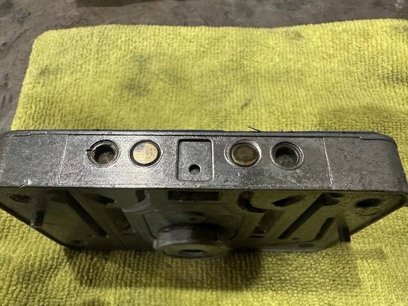

I left the carb at work. I will take pics of the top of the block tomorrow to show the plugs in the top. Best pics I currently have are below and it’s hard to see.
I dynoed a truck avenger carb for a customer some years back and it was like in the picture, no emulsion holes. It ran good on the dyno.
I see two emulsion holes in the dog leg area. They look to be well above the fuel level.
The lower hole in the dogleg is a kill bleed. The upper hole is bleed air from the main air bleed. Neither of which I would call “emulsion”.
For reference only, here is another block I have here, numbered 5882. This block has emulsion tubes as well as emulsion holes.

So it looks like it has the emulsion tubes. I don't think you have to treat it differently than any other 4150 unless it behaves in way that requires investigating the e-holes.

You can call it a kill bleed but the fact is it is connected by the passage to the emulsion well, so the air is 'connected'.
