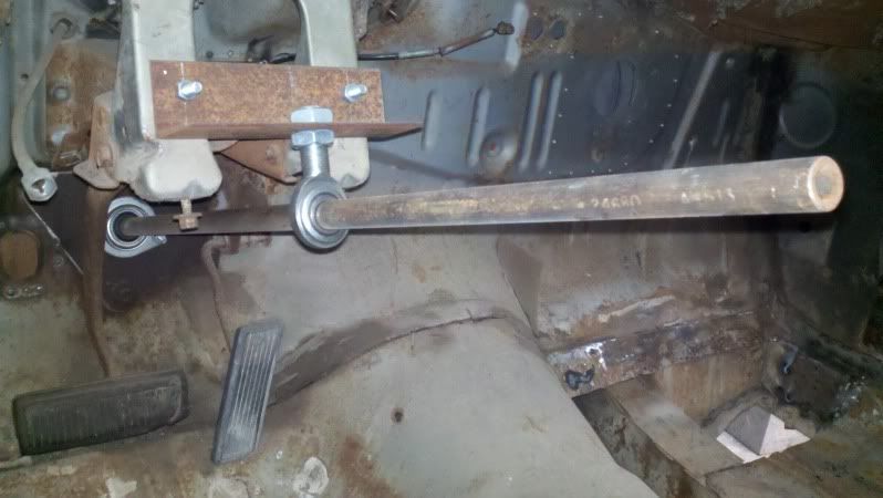

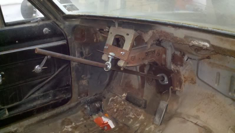

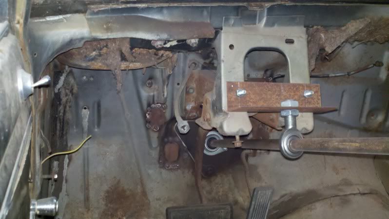

Here is a break down of parts needed.
1) steering wheel of choice
2) quick disconnect coupler for steering wheel for 3/4 tubing
3) some type of mount to attach to dash. they make a oversize Heim joint to do this

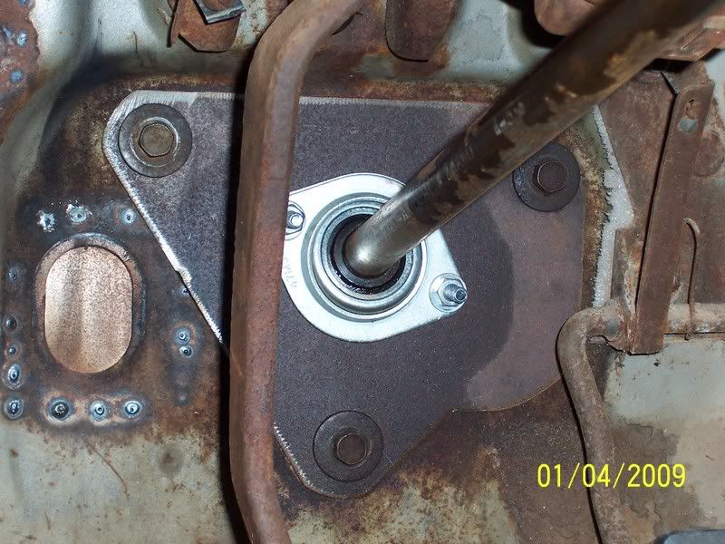

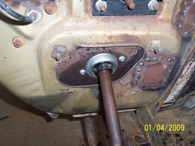

4) a firewall mount

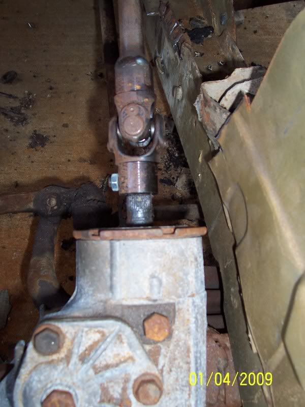

5) a universal joint couple that adapts to your steering box
6) about 3-4 ft of 3/4 o.d tubing
I will look for the pics I have of my setup I made for my cuda and get them posted in the next day or so.
here are some pics
Thanks I may have asked the question a little early shortly afterward I actually found another idea like that but your pictures are great as far as how to get it installed in the car.
Yea summit or whoever sells firewall bearings like that for about 20 bucks and up. I got most the parts coming just need ths tubing
