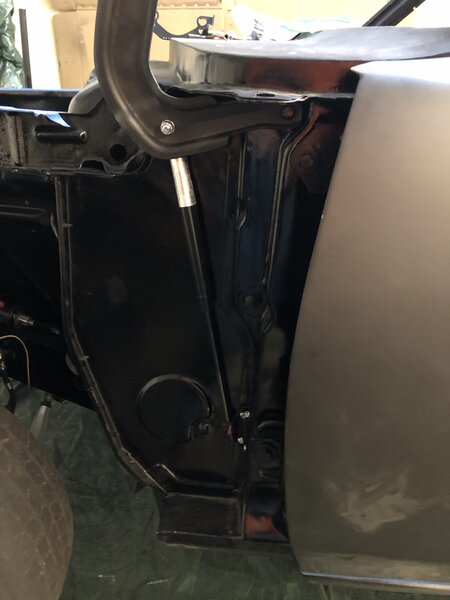

My 2017 Mustang convertible had a Chevette prop rod. That was the first thing I replaced. An expensive, classy car held up by a coat hanger? Not in my garage.
When trying to close the hood I now recall loud creaking and having to favor more pressure on the driver side when closing the hood. Looking at the parts now, I see the rusty spring which made be the reason for this. I have a post in the parts wanted section for a replacement. In the meantime I'm going to try to clean and lube the spring, straighten the arms and see if I can get it to work.
Hmmmm... I was wondering what everyone was talking about "prop rods"
That looks like a good idea.
Thanks everyone for your input and guidance. I thought another stock hinge was the answer and I briefly consider a hydraulic prop rod, but wasn't interested in fabbing it to fit and having one side stock and the other modified, nor was I into making them both the same. Most of the problem was the rusty spring, so I soaked it in some Metal Rescue for a couple days which helped, then I put in the vise sprayed it with PB alternating with brake cleaner to wash the rust away while working it with a piece of pipe on the arm. I did the same with WD a couple times. After a good does of litithium spray, I worked the arms back into shape, bolted everything back together using a nylon washer between the arm's and a nylock nut to snug it up. I also used a washer and cotter pin to keep the spring from wanting to walk off and it's working great now. I hope it stays that way.
