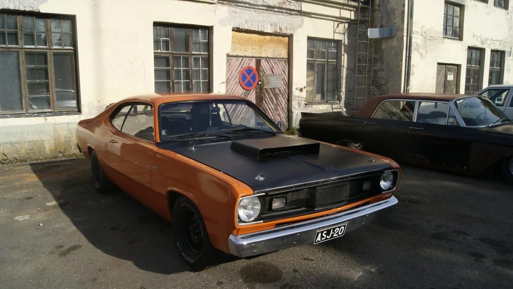

Hello everyone, I'm an 18-year-old punk from Finland (Europe) who just bought a Plymouth Duster for my first car last spring. I drove it around all summer and autumn and this winter I started to make some changes.
I started with the 360 engine that was in the car.
I'm doing everything on a low budget 'cause I'm just a poor student.
Here's the recipe for my engine:
- 1975 360 block, bored .040'' over
- #587 heads with dual valve springs, I'm going to have a machine shop cut for 2.02'' intake valves. Do a 3-angle valve job, porting and polishing myself. I was also thinking about lowering the heads for higher compression.
- For camshaft I have a H-278-2 from Crane cams
- Comp lifters
- Comp timing sets
- Edelbrock performer intake
- Right now I have a Carter AFB competition series carb (750cfm) but I know it's too big, so I'll probably go for a 625-650cfm
- Hedman hedders
And now I was wondering how much horsepower should my 360 have when I'm done with it? I can't afford to take it to the dyno just yet.
I'm also interested to take my Duster for a 1/4 mile track next summer. It has a 727 trans with a shiftkit and 8 1/4 rear with 3.23 gears and a sure-grip, any ideas for what time to expect?
Hood, trunk lid and front fenders are fiberglass so the weight should be around 2900lbs (?)
Thanks!

It looks like you have a skinny tire there now. That makes the car traction limited with even a low compression engine. With that I see and your given information I'll say you have a mid 14 second car as it sits right now. And that would be with stock heads and exhaust manifolds. (You didn't say anything about the exhaust.)
Oh! By the way, a 750 is not to large for it but it will take careful tuning of the carb and ignition to get it feeling good and right. I myself perfer a smaller carb for the street and driving.
If you use a wider tire like a 235/60/15 (26 inches) your traction problems will be less. Good springs are the other half. Once you can get off the line well, I can see a much better time slip.
Nice ride by the way.

Oh forgot the exhaust, I have a 2.5'' stainless steel exhaust all the way to the back with some old mufflers and Headman headers
For tires I have 14'' BF Goodrich radial TA's (235/60/14 in back)
I'd like to have bigger back tires (something like 275/60/15),
I already have modified inner fenders for big slicks but the springs are still in their original position.
I really don't know what converter I have but I think it's original.
Pistons don't say anything but 040 on the top...
This Duster is my driver that I will drive to school/work everyday so I don't want anything too radical.
Just a nice street car that I can have fun with and is fast enough to smoke my friends' BMWs and Subarus :burnout:
