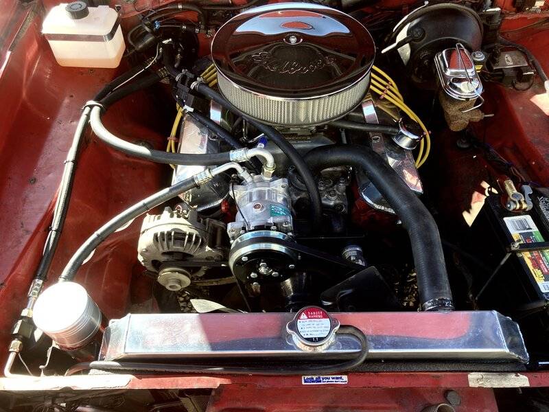

Silicone over steel Magnum gaskets with fabbed aluminum valve covers, so no retightening here.
