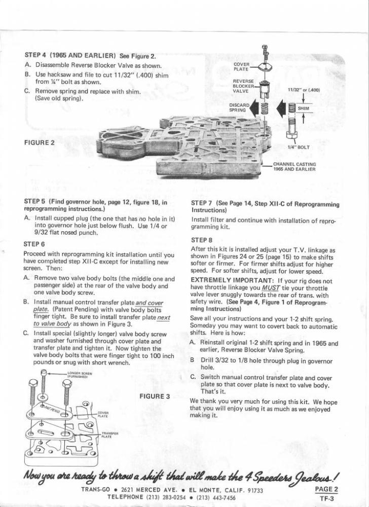

- Here is what the governor valve looks like. You're going to need to modify it as shown in the instructions (page 2, step 5)
- Here's what it should look like when you're done. The instructions say it can be done using a grinder. I didn't want to fiddle with it, so I just had a machine shop turn it on a lathe.

- Now you're going to replace this spring with the one in the kit (pictured).
- Now you're going to need to do some drilling on the plate.
instructions explain which holes need to be drilled. You also may not need to drill these. It depends on your specific valve body so consult the instructions on this.

You'll also need to adjust the TV screw, but I forgot to take pictures of that. The instructions detail how to do it.
