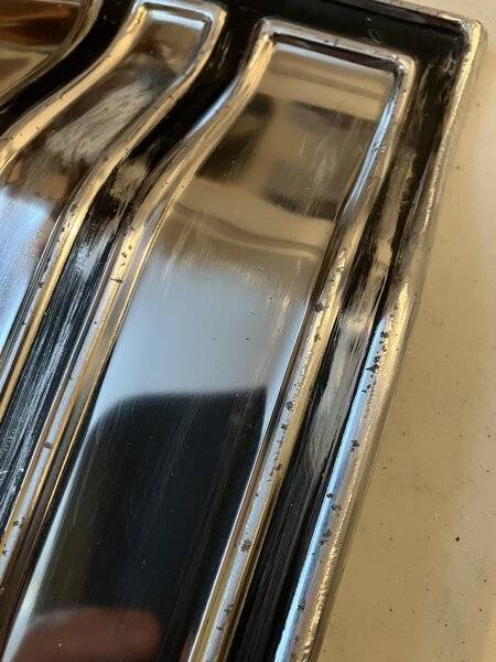

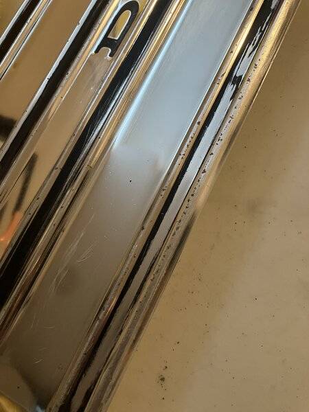

Hello Everyone
I’m attempting to restore my 68 GTS Tail Panel. Overall it’s in great condition. I have some pit marks at either end of the panel. You can’t feel them with your finger but you can see them. Is it better to file them out or sand them out? I’m definitely a rookie at this. Thanks for your input and guidance.
Stu.
That is anodized aluminum. If they aren't too deep you can strip the anodizing and sand them out. Finish by polishing the raw aluminum or send it off to be re coated.
You can’t feel them with your finger tip so they can’t be that deep. Thanks!
I agree with toolmanmike.I'm sure they can polished out after removing the anodizing.
Only thing is you have to strip all the anodizing and paint before you can reanodize after you have polished it.
There is a company in Cambridge that does anodizing and the will be re anodizing my grille and bezels once I have them ready
My buddy block sanded and polished nearly all the trim on my car, both aluminum and stainless. He didn't strip the parts, but essentially sanded it off by hand.

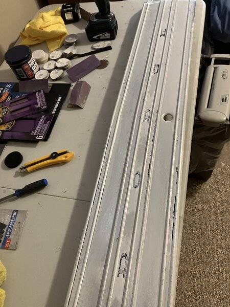

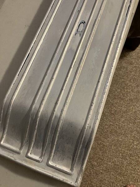

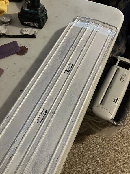

I just got the anodizing off yesterday. I had no idea it would become “milky white” in appearance.
