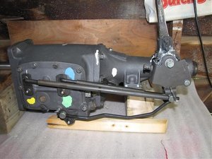

I just install a new tranny i installing a new shifter and i cant figure out what gear it is with linkage un hook
Got this from another member...........Look at the shift tabs. This is neutral. Mine didnt look exactly like this but it was close. I had the same problem as you.........
Notice the drill bit in the shifter mechanism, the drill bit holds the shifter in neutral.

I believe the lever all the way back is park. Someone else will chime in I'm sure. Here is a bump for ya anyway.
