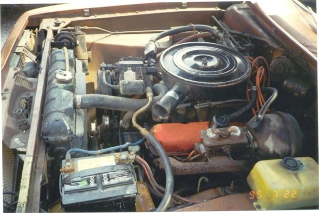

That would be a great car to save Jim. Having owned several Barracudas over the years I just noticed two small things from the pictures. It looks like the original 22 inch rad rad has been replaced with a 26 inch rad. I also see an adapter ring on that carb, so perhaps the original carb was replaced by an earlier AFB? This is a picture of the engine bay on a 50,000 original mile 68 Formula S notch I used to own.

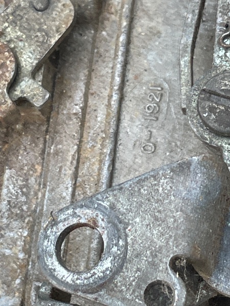

The carb is not original, the one in the trunk may be. Does this tell?

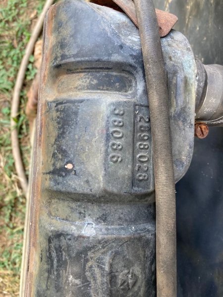

It did not look like the radiator was changed. That would take changing the support sides wouldn’t it?
A 26" radiator can be put on a 22" support by just centering it up and drilling a few holes. Hackery.....but it works in a pinch! The carb numbers are on the front edge of the mounting bolt boss on the front passenger side. I think @RAT ROD AL had a few 68 or 69 340 carbs listed the other day.
