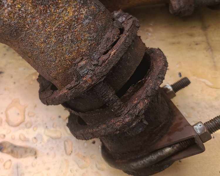

The old headers are out and the new shorties are in. Cutting them makes it easier to get to the flange bolts.
What brand? Were they rusted to the point of leaking?
Were they underwater at any point?
Hedman, they rusted out and had some major leaks, even one of the tubes had split. Road salt eats them, and they rot by the ball flange thingy. No amount of paint could protect them, so I got tired of dealing with long tubes and went with shorties and a Y-pipe. The shorty headers will last longer since they are not as low.
Once again I have a quiet truck now. When the paint finishes burning off, I,ll spray them with some high temp paint. By going with Hedmans, you are not saving much money, so buy better headers if you can. Future readers should take my documentation as a warning and don't let the "Proud to say, made in USA" text fool you. I knew what I was getting into, it's fixed now.
