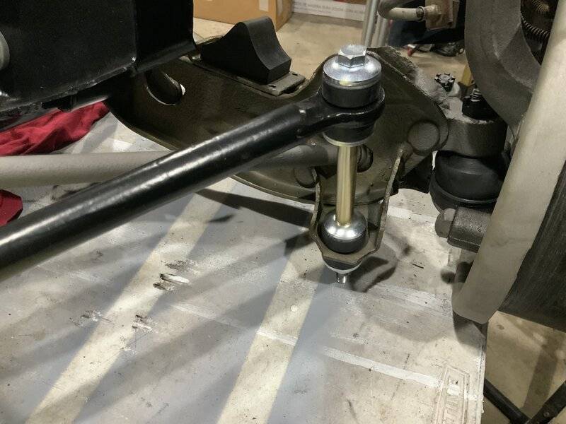

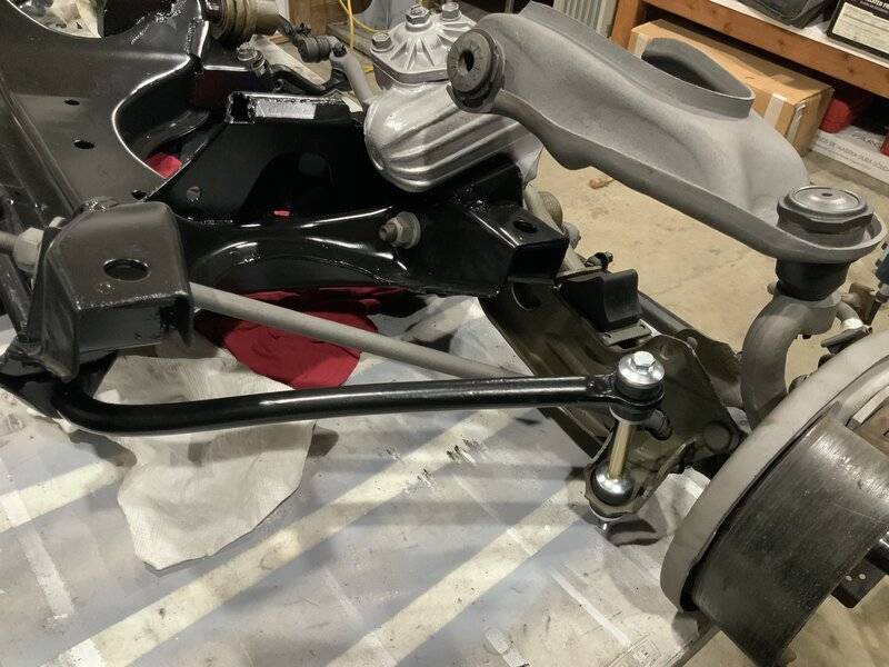

I was wondering if someone could post a pic 66-72 a body with front sway bar
Here's a couple of pics at the start.........You get the idea. Hope it helps
I will be replacing my bushings and suspect that I will cut the metal to remove and replace the rubber, then re-weld.
Thanks, could you send one from the underside where they mount,I could be missing hardware
Unfortunately I am away from my car. Not much hardware........Rubber triangle strapped on to a metal base, with 2 bolt holes in the base to attach to the K frame.
I'm missing the plate that bolts to the frame and has mounting holes for the bushings / clamps
fyi, all three series of bars and mounts are unique. 64~66 mounts are different from 67~72 as are 73~76
there is *some* cross pollination in the aftermarket and with end links, but the mounts themselves are all specific to those year ranges.
