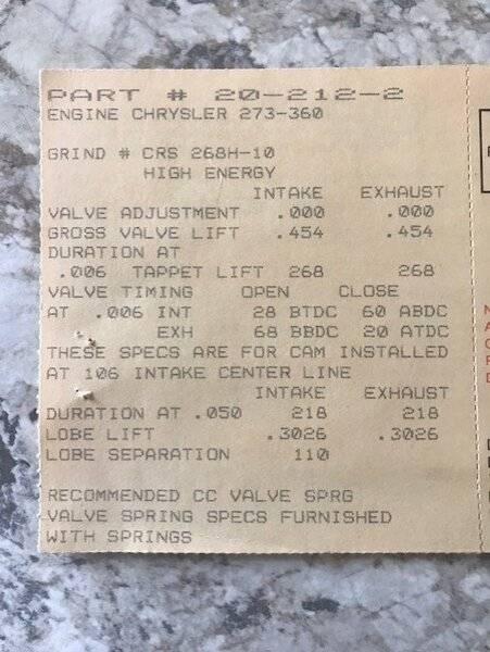

Rat Bastid Dunamis Metron Joined Nov 23, 2020 Messages 4,900 Reaction score 5,508 Location 22 The Avenue Feb 15, 2022 #2 Comp 268
F/A Tech Well-Known Member Joined Aug 26, 2017 Messages 71 Reaction score 34 Location Vancouver Canada Feb 15, 2022 #3 Cam was installed in 1970 340 4 speed in 1988. Motor is running fine so don't want to pull it apart. Can someone tell me about the cam from this paperwork thanks.

F/A Tech Well-Known Member Joined Aug 26, 2017 Messages 71 Reaction score 34 Location Vancouver Canada Feb 15, 2022 #4 Rat Bastid said: Comp 268 Click to expand... Thanks
69FBCuda Stand back 10' for your viewing pleasure & Safety Joined Aug 28, 2014 Messages 4,437 Reaction score 2,095 Location Florida Feb 15, 2022 #5 High Energy 218/218 Hydraulic Flat Cam for Chrysler 273-360 High Energy 218/218 Hydraulic Flat Cam for Chrysler 273-360
C ch1ll FABO Gold Member FABO Gold Member Joined Jun 12, 2009 Messages 2,619 Reaction score 2,245 Location Belgium,wi Feb 15, 2022 #6 About a step up from stock automatic cam. Still a really mild street cam.
George Jets 1967 Dart 2 Door FABO Gold Member Joined Jan 18, 2019 Messages 9,997 Reaction score 14,462 Location Farmington MN Feb 15, 2022 #7 Lift: 454 Duration: 268° Intake Centerline 106 Exhaust Centerline 114 Lobe Centers 110
