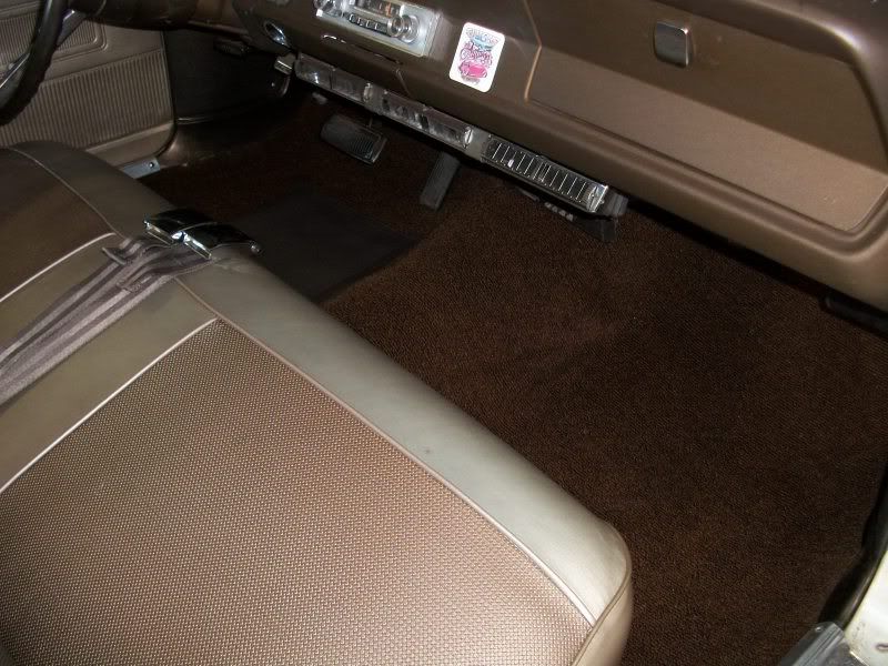

If you havent already done so... you might want to run a search on Sound Deadening/Vibration Damping Material that also serves as a heat barrier that you can put down before the carpet.
What's the better route? Sound deadening material or the spray can bed liner stuff?
