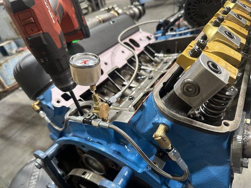

If one has a Magnum block but wants to use LA pattern heads, how do you get oil to the rocker shafts? I thought that the Magnum didn't have that oil hole/passage that the LAs had.

Option 1. You can have the block drilled, cam bearings installed with the oiling hole, and a cam that is drilled for timed oiling.
Option 2. Run external oiling, plumbed from the oil gauge port to the back of the heads. Involves drilling heads and rocker shaft bolts. Restrictors need to be made/installed because you’ll have full time oil and lots of it. I have a magnum bottom end with W2 heads and I use .040 per side.
Either way, if you’re using magnum lifters you can also use purshrod oiling for the adjusters.

If you have a Magnum block with no head oiling holes and you successfully drilled the two holes, you then install LA style camshaft bearings and LA style camshaft drilled for LA oiling as well. That is it. Then you can run any LA head and treat the top end as an LA with rocker shaft oiling.
Trick flow heads can be used on Magnum blocks without the oiling holes but you have to use pushrod oiling. That means lifters, pushrods, and rocker arms that have pushrod oiling provisions built in. Trick has a Harland Sharp rocker arm kit part number they recommend for this.
You can actually run any LA head on a Magnum block as long as the correct pushrod oiling setup is used. Comp Cams Ultra Pro Magnum rocker arms, and the copies like PRW, have the pushrod oiling provisions too.
Excellent work on your plumbing,,,,,looks great,,,,,,good looking engine too !
