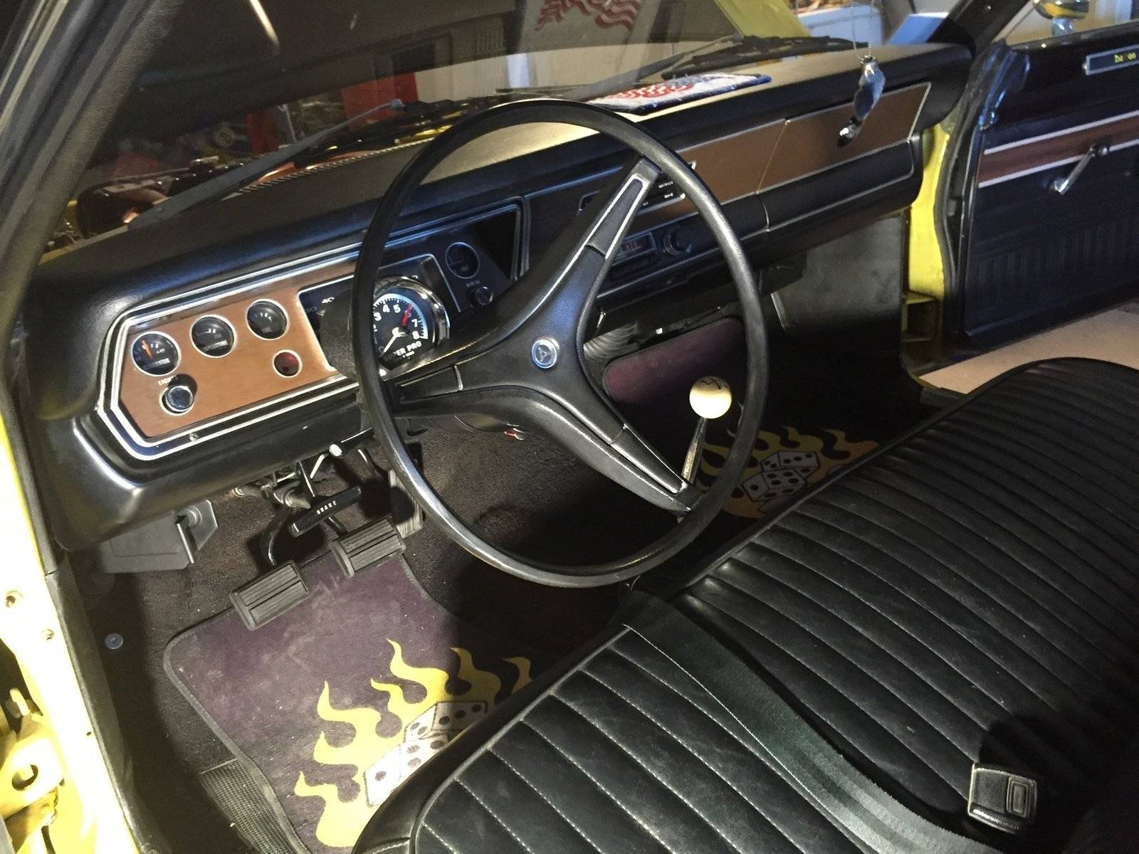

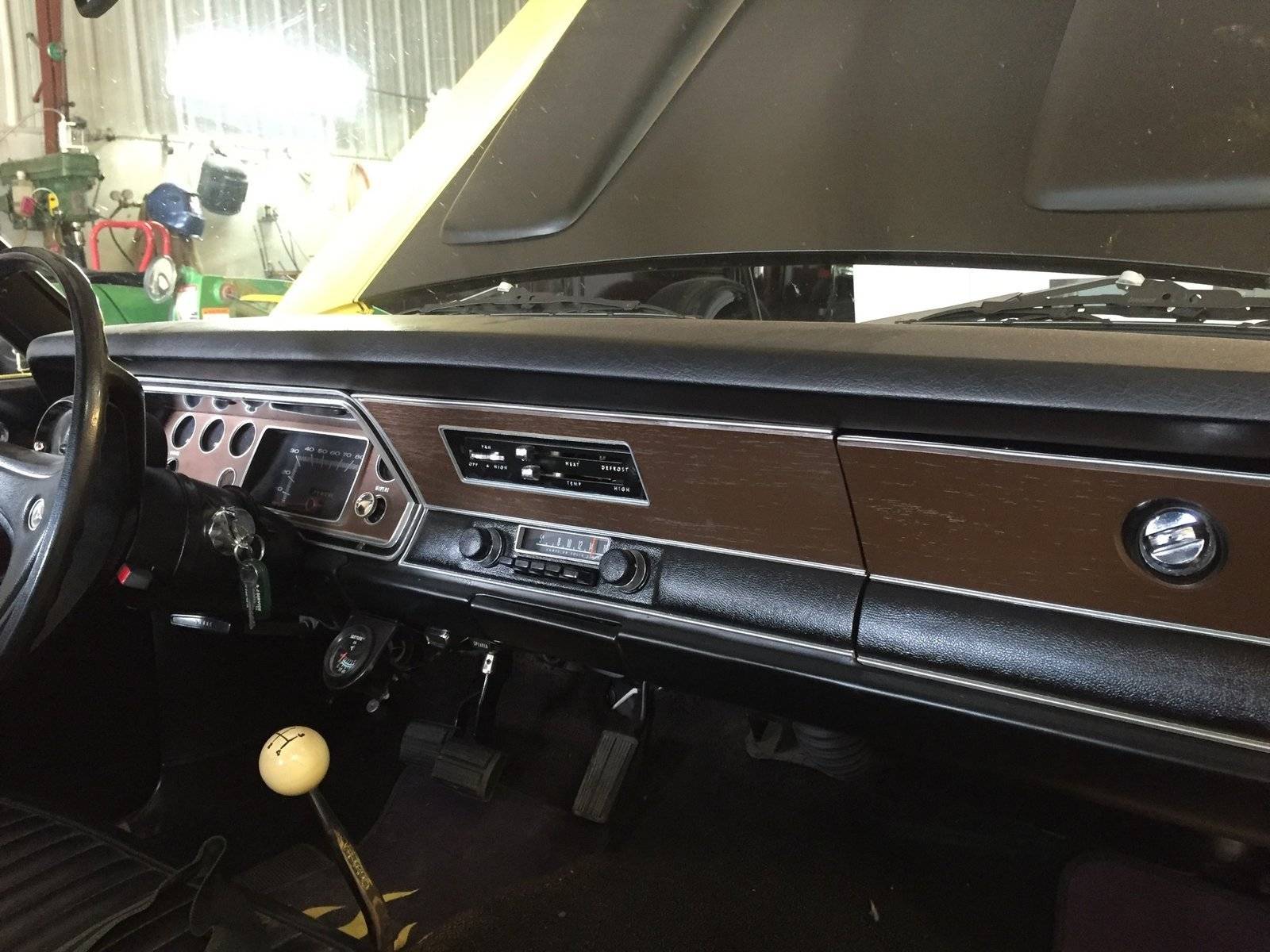

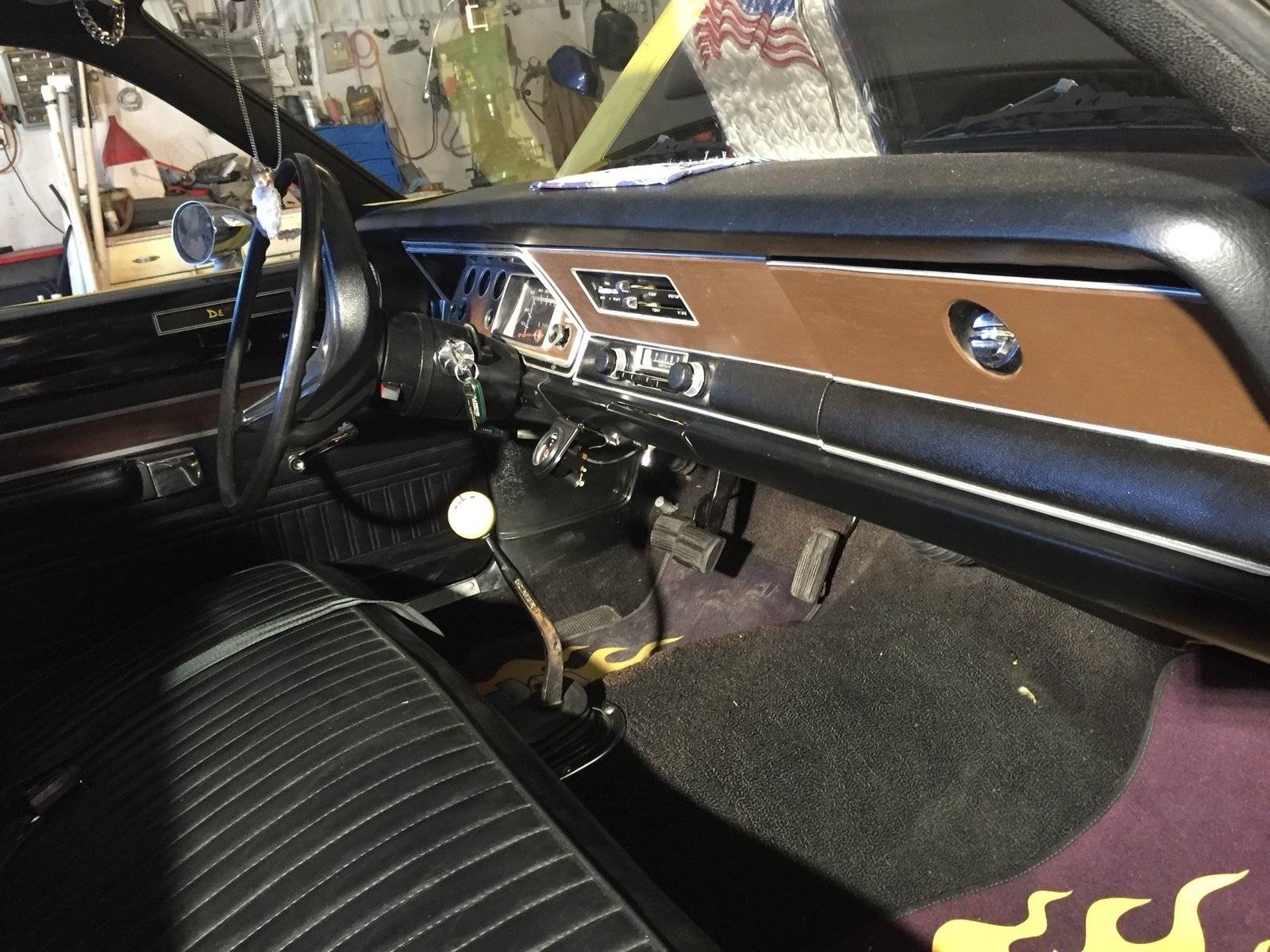

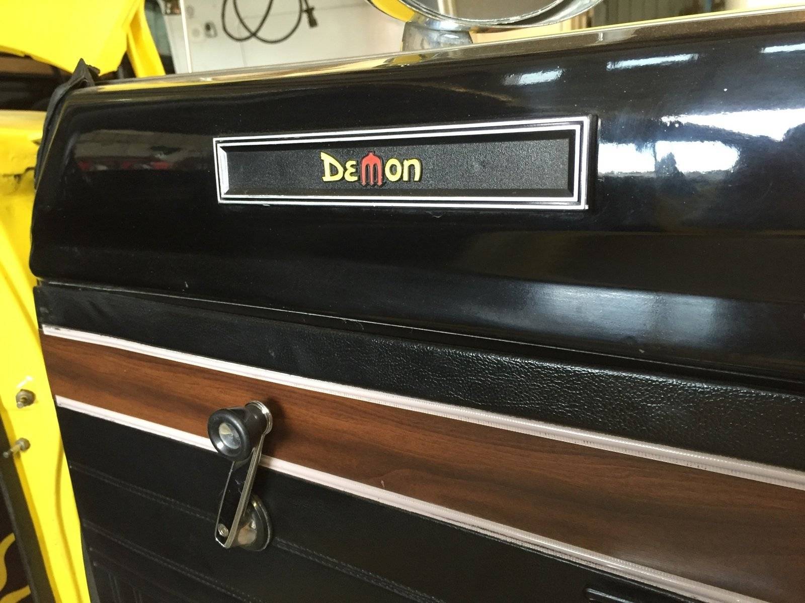

I actually re painted my dash by removing the plastic panels. I masked and rattle can painted the satin black and wood grain . I did use a silver pen to replace the chrome. I also did the steering wheel and door insignia.The pen takes some practice to try to keep it looking as good as possible. I don't think it looks too bad but you probably wouldn't want it on a trailer queen.

"View attachment 1714978147 View attachment 1714978145 View attachment 1714978146 I actually re painted my dash by removing the plastic panels. I masked and rattle can painted the satin black and wood grain . I did use a silver pen to replace the chrome. I also did the steering wheel and door insignia.The pen takes some practice to try to keep it looking as good as possible. I don't think it looks too bad but you probably wouldn't want it on a trailer queen.
Yote
No, it doesn't look "bad". If you do all of it with that silver pen, it does look O.K. But touching up spots of missing/worn chrome, which I assume is what the OP wants to do, is a totally different thing.

What paint did you use for the woodgrain on the panels? I think yours looks GREAT!!
I used Krylon fusion for plastic, satin espresso #2436 for the wood grain. Krylon fusion satin black for the rest. I followed that with Ace clear satin polyurethane # 17015 in very light coats to give the paint (especially the silver) more durability.
