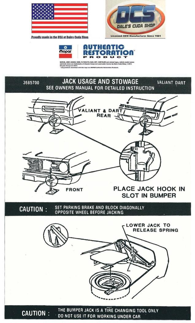

1972 was the first year for the hook type jacks and slotted bumpers. Your bumper has slots so I would say yes it's for your car. Your rear bumper should have slots also and your bumper should be the hook type. If you still have the jack instructions on your trunk lid it should look like this https://s.turbifycdn.com/aah/yhst-7...ng-instructions-trunk-lid-decal-3585700-3.gif. Any 1970-72 Duster/Valiant front bumper brackets should work on your car. Wildcat Auto Wrecking should be able to help you Wildcat Auto Wrecking | Mopar Parts | Classic Car Dealer.
