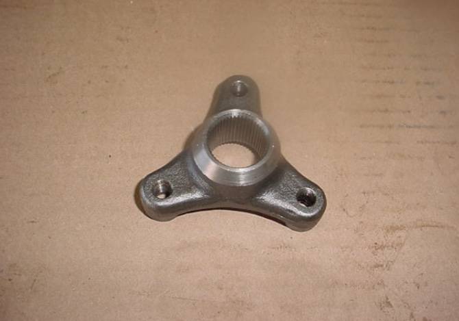

Above is a 7/8” coupler

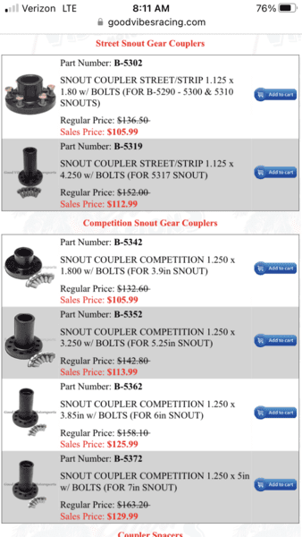

Above are performance couplers in “street” 1.125” and competition 1.25”
Jacks shaft measured 1” (LOL) so I’m assuming he has a 7/8” spline coupling
