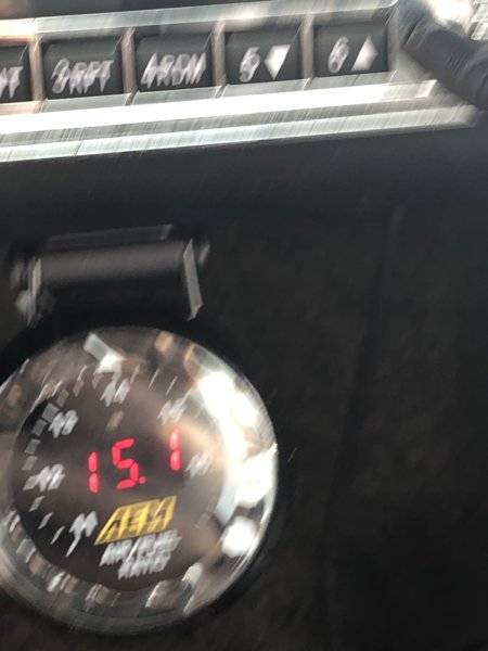

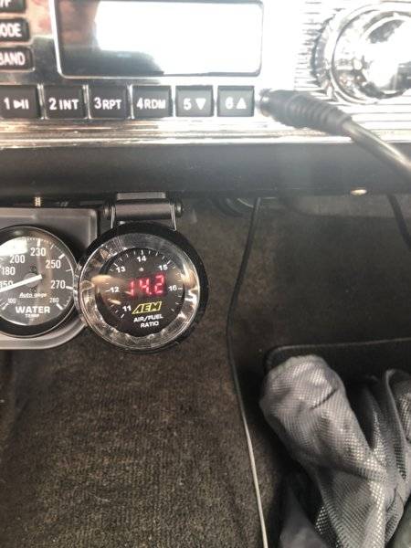

Did you ever install the wide band AFR?
Thanks again!
Yes I did. For a while it would error out on Lean. But there was zero doubt I was running rich. On a warm day, it worked for a few minutes and displayed in the 13s - which is rich and I felt accurate. Than leaned out. Fixed the carb, redid the curve and threw more initial and low and behold it started working . It went through a bit of a cycle as I was driving. Been reading 14.6 since. To be honest, I am not 100% confident in the reading.
Ace fuel uses an old school analog "sniffer" and like i said if you get the right guy they can do a hell of a job.
If you get some "new guy" well lets just say they dont teach how to use that machine at tech schools..
I went to ace with a pocket full of cash and they turned me away as they will not bother with multi carb engines as "they take to mich time to tune".... so they are not the end all be all of carb tuning....
Nor am I but we can play with it and see if it gets better.
