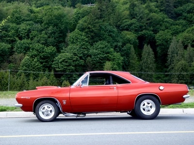

Welcome. There are a few threads on this topic you can search. Barracuda's have plenty of room to go wide. Tall is the limiting factor. There are some members that are using 275/60-15s but its close to hitting in the front. Here is how close my 255/60-15s fit.
