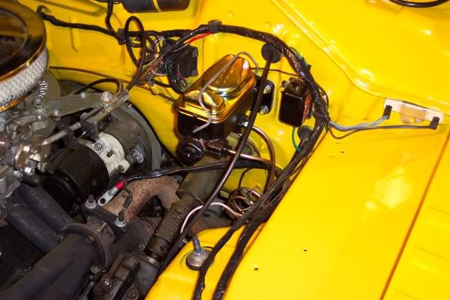

I redid the factory KH manual disk brakes on my 1967 Dart this last spring. I replaced the master cylinder with a later new “manual” disk brake unit. It is larger than the ’67 master cylinder that was on the car. It bolts right up, but you may have to install a reducing bushing or two to use existing brake lines if I recall.
Power brake master cylinder will be a different model number, and bore size.
I posted about this upgrade here: http://slantsix.org/forum/viewtopic.php?p=304772&highlight=master+cylinder#304772
The new master cylinder works great. By the way, I replaced all the front brake lines as well. If you have a question about this upgrade ask Slant Six Dan, he can probably help you.
Cool..thanks for the information, link and the photograph.
I have manual brakes and my master cylinder (from a manual brake car) looks just like the one you have on your car.

I think you have it backwards, 15/16ths bore is manual brake master cylinder. Larger bore, 1 1/8” or whatever, is used with power assisted brakes. Theory is the longer piston travel, and smaller cross sectional bore provides lower foot pressure to move a given volume of fluid, in relation to larger cross sectional bore requiring more force with less piston travel to do the same work.
This is the same type master cylinder installed on my car, it works fine. You have to exert more foot pressure on the brake peddle in relation to power brakes, but you can still lock’em up. There is better peddle feel, more linear if you will, with manual brakes, than the mushy numb feeling vacuum boosted set-ups from the 60’s & 70’s.
