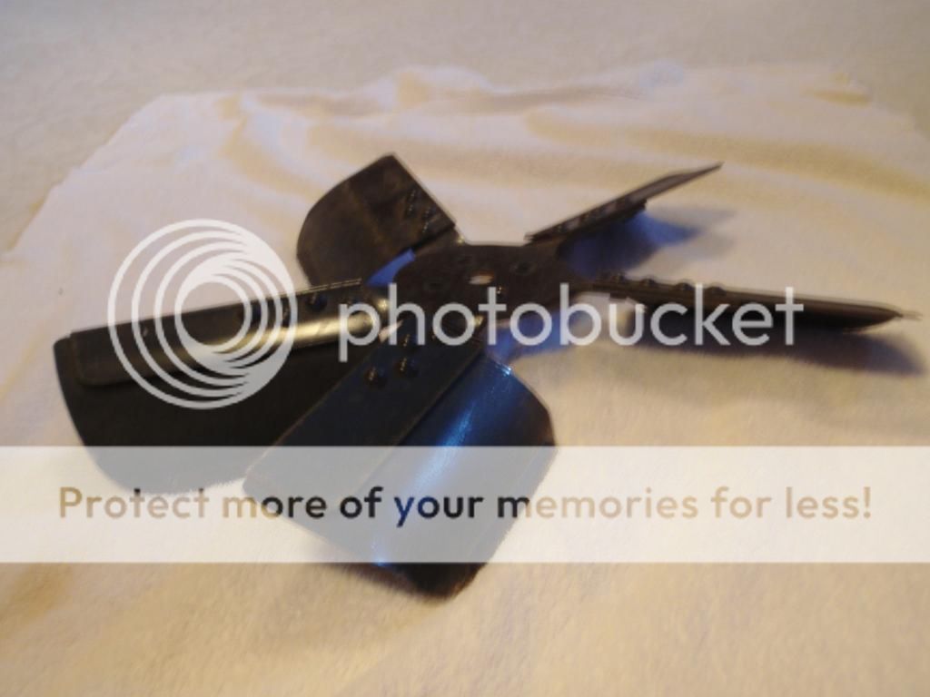

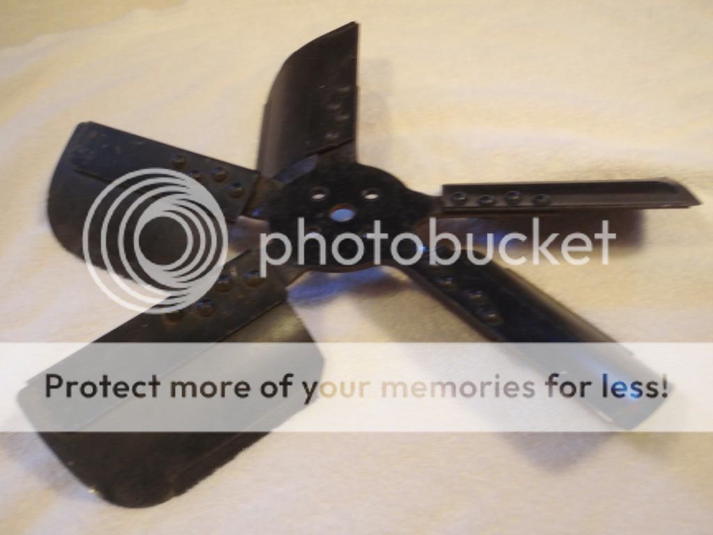

Thank you 66. So now that we have pics, does anyone know what vehicles may have come with these?
They came on a lot of 70's and 80's MOPAR cars and trucks. You have to keep a lookout for them, even slant sixes. And eBay of course. My experience is that the OEM flex fan will pull more air than a fixed blade or a clutch fan at idle. Even if you give the fixed and clutch a shroud. They probably take more power to turn, but overheating is a real pain. Measure OD of your fan and start your search. Good luck.
If you're not worried about stock and are going to try a flex fan just get one from Summit. This fan is made in the USA and moves a phenomenal amount of air. I was running one on my Duster, but went to the electric fan set up because I was running too cold with the flex, even without a shroud.
http://www.summitracing.com/parts/sum-g4917/overview/
But you can assume that it will also take a big chunk of horsepower to spin it.
