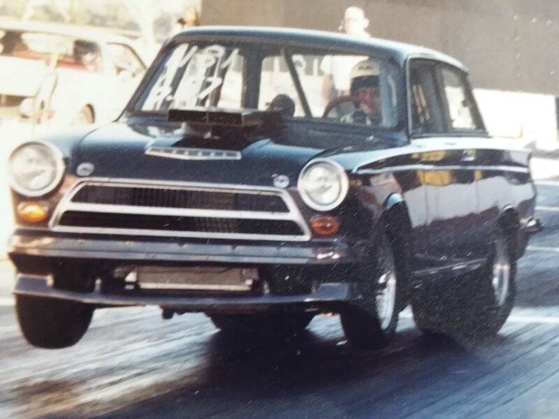

Brooks, if you DO do the turndowns before the back axle, tip the turndowns TOWARD each other, at about a 20-30° angle.
It smooths the sound, and pushes the exhaust out the back, instead of onto the ground, and blowing whatever onto the bottom of the car, or other guys cars.
That's what I did on this car, and it works.
Thanks, I love advice from "been there doing that now".
I will do just that !
I was concerned about fumes possibly coming into the car
Also Don't need the exiting heat on the pan of the car
Your car is absolutely bitchin, sick !
