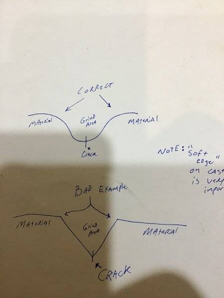

Note, as another molecular thermal fusion specialist the above guidance is spot on for brazing the cast, I would just add to be sure and when grinding crack soften the edge or grind a bit of curve in. The member responding likely took it for granted the OP already knew that but figured I would add for clarity.
Please assume I don't know a damn thing. :realcrazy: In grinding in a curve, is that a curve in the weld joint area like the opposite of a cut with a chop saw or a radius on the edge to be welded like a bullnose edge on wood?
See attached pix, Disclaimer: I am not an artist!
Also spot on as a master of molten metal.
I also would add when you grind out a crack. At the ends of the crack first thing is to drill a hole on either end straight thru the metal. It can be small like 1/8” but make it proportional to the crack. This stops the crack from going further. I typically find the end of the crack and using it’s projected path drill about 1/2” to 1” past what you can see because cast (steel or iron) cracks thru the grains of the metal.
