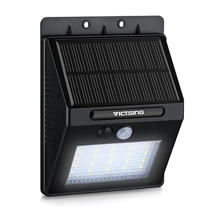

how about something like these?
https://www.amazon.com/dp/B00T1O1DXY/?tag=fabo03-20
I thought about those, but I wasn't sure about battery life
do a combo, a solar setup like above, but a couple of these for when the kids just wanna randomly run in an play.
