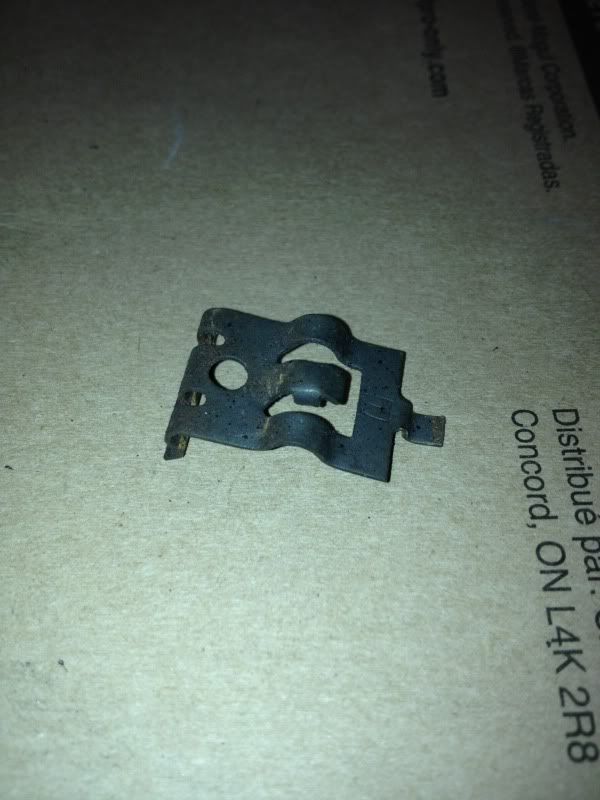

I am looking for a clip like this. After changing out the heater core on the 64 valiant one clip left to install. The last clip came flying off and it is gone, looked everywhere..... so I need a least one..... thanks
Look on the speaker magnet ? I can mail one to you for the cost of shipping.
Hey just noticed....the cardboard box in the pic...Concord Ontario, whats that from?? Whatever it is, it made a good journey from ON to Ky. LOL
No speakers, damn thing went flying and is gone gone gone.......hate little clips they always seem to go flying and get lost.....
Do you have paypal?
Heres a tip... See the little hole in the clip ? There's a matching hole where it attaches. Drop a wire, zip tie, most anything through the holes when installing or removing the clip.
Thanks one an all........ Got one from MoparParts.......:cheers:
