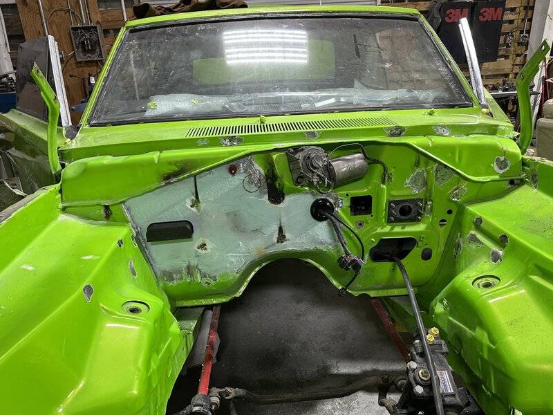

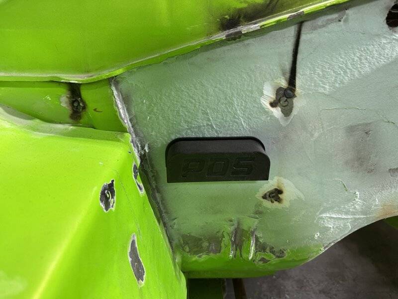

Need help…Looking for photos of a small block in the car without an intake installed but hopefully with a distributor installed.
I need this so we can locate a position for a wiring harness pass through in the fire wall.
my engine is out of the car due to some firewall work we are performing and I just need some reference for placing the opening.

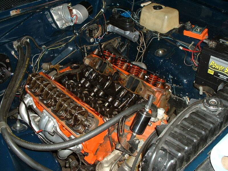

Best I got. The pass side cap edge on the distributor is slightly to the pass side that upper wiper motor mount stud.

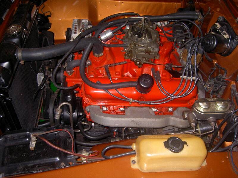

Not exactly what you are looking for but hope this helps. 69 Barracuda.

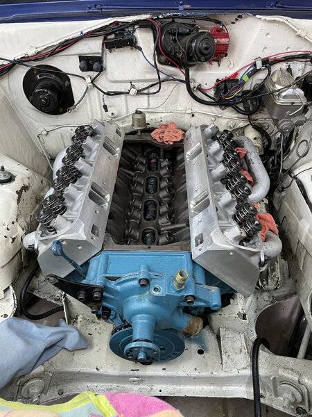

I am putting my coil in the engine compartment and running the coil like you did.
Also putting the ECU and relays for fuel pump and electric fan in there too.
I am finally getting around to using the battery relocation kit you made me, lol
Thanks and Happy Holidays bro!

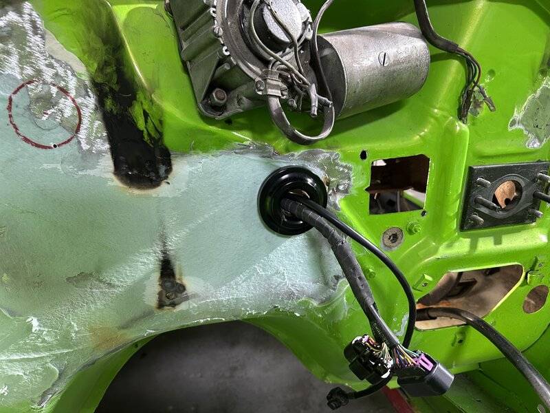

Looks kind of familiar... LOL Mounted where the heater box would go. Used the AC openings to pass the coil wire oil pressure gauge line.
