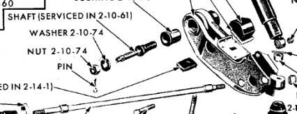

So in my re-re-rebuld of my car, I noticed these guys were missing, leaving a very noticeable gap. Can some one give me the dimensions as they don't look to be a standard washer. The washer I'm referring too is 2-10-74 in the pic below. Thanks!
I just pulled the front suspension off the 65 Dart I parting and that washer is pretty thick - at least 1/8 in thick. I can get you a more accurate dimension tomorrow.
The one I put my calipers on is .255 thick (1/4 inch) and a 1.285 diameter ( 1 & 9/32 inch )... with the center hole of .665 ( clearance for 5/8 )

I went to the local Ace hardware and got a good grade 8 - 5/8" washer for ours when we did it last year....
